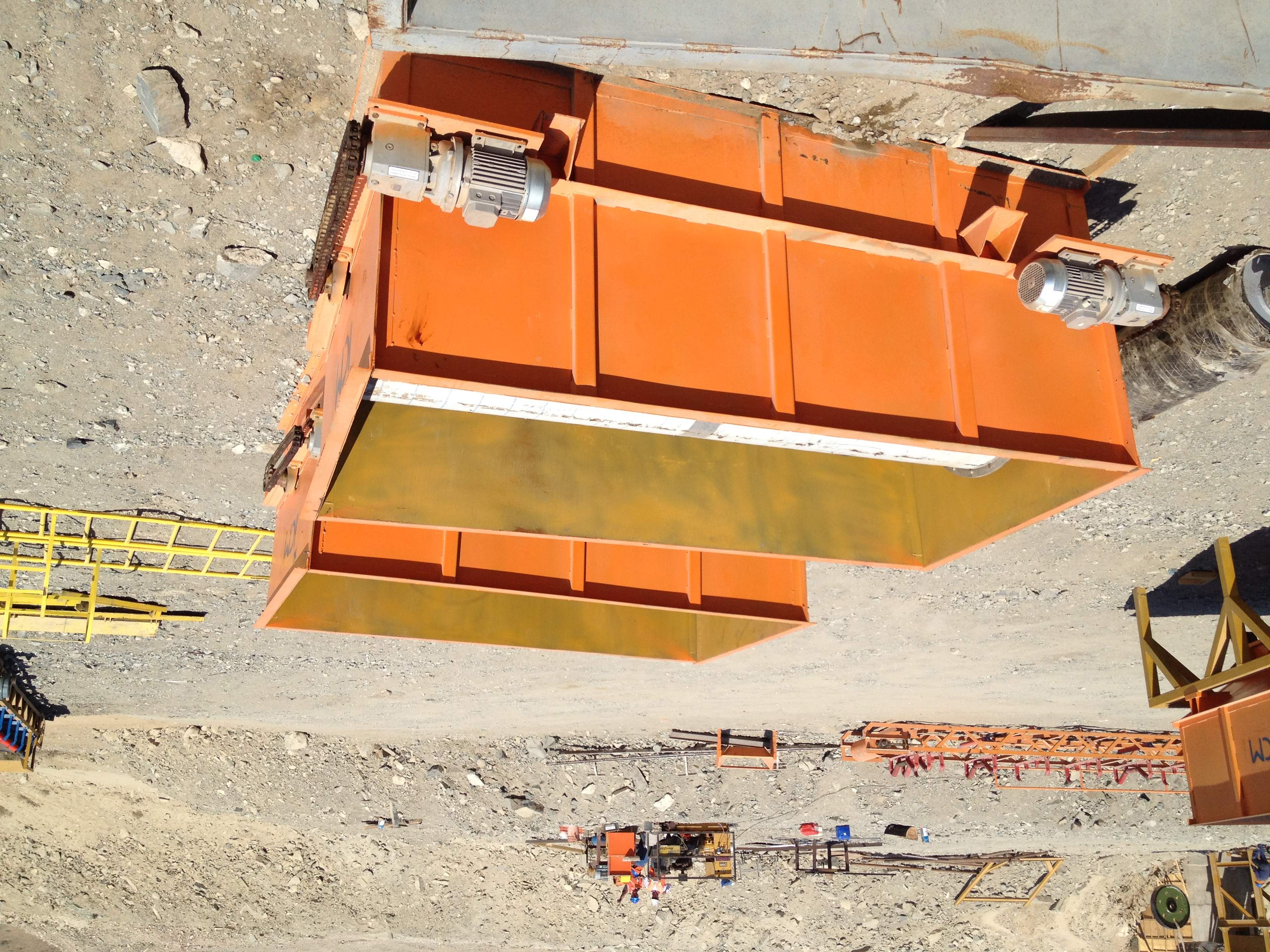

I am working in an iron ore mine and we need to build a 3m long magnet x 5cm high x 5cm
variable from 500 - 10,000 gauss
x 30 rows (i.e. 30 identical EM's)
We need to know:-
the ideal core material, guage of electrical wire, number of turns/ layers to wind, current to pass
The ore is crushed 1mm to 5mm particles.
Well how did you decide that it should be 3 meters long and 5cm high and 5cm wide?
The current separator we have uses static 1000 gauss magnets, which we want to replace with EM's of the same overall size.
Also, what kind of current supply do you have (it takes a fair bit of current to energize an electromagnet)?
we have 1mw of power supply on site.
Also, why are the constraints so strict (500 to 10kG field strength), why that level?
the iron ore we are passing reacts best to these field strengths.
Also, how close to the surface of the magnet will the ore be placed, and how fast will it be moving?
6mm from the magnet to the ore, with a stainless steel rotating drum in between. This will rotate at 0.5-1m/s
mag separator pic
I assume you want DC for the magnets rather than alternating magnetic field. So you need high current low voltage supply. Mild steel is the best core material and since its DC it doesn't need laminations. The steel won't do a great deal of good as the air gap is large. You need to get a good reference on large rectangular inductors. There are various fudge factors used for various sizes. Once you have an inductance value for the given size you can evaluate the average flux density. Another way is to simply build a scaled inductor and measure its field strength vs current, then scale the results.

I didnt know you already had magnets, but they are solid magnets not electromagnets right?
Also, they are 5cm by 5cm square cross section, by 3 meters long. So there are four sides 3 meters by 5cm each, and two sides 5cm by 5cm. So what are you calling the 'face' of the magnet, is one of the 3 meter by 5cm sides? (The face is the side that is used to attract the particles).
It's a little hard to tell what is what in the photo, maybe a few more angle shots would help and maybe label each part.
yes they are solid magnets at the moment. approx 1000 gauss. we want to replace these with EMs of the same size which can fit into the same space in the frame/ drum. The current magnets are 20mm x 30mm x30mm. so there are 100 pcs lined up to make up a 3m span.
Can we wrap these with elecrtical wire and charge it to make the magnetic field stronger.
we need variable from 1000- 5000 gauss so please advise spec of cable and winding and elec current we would need?

Also, can we see a picture of the magnet and the magnet where it is mounted in the machine itself? Vids didnt help here.
