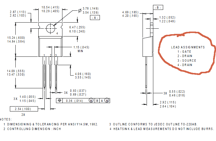

Hey guys, need a pinout for the IRF4905 P-channel MOSFET. Laying it on its back, what exactly is the pinout? Thanks
Non of the data sheets had direct info. Tried before I posted. I did find 2 results with google pics. Appears to be
G D S
Will find out tomorrow when I get the remainder of needed resistors and complete the project.
The package outline and pin out is on the data sheet I referenced.
Hi FireAce,
I hope this is clear enough. :)
Regards
Boncuk
Thanks Boncuk, that is what I found, so I'm good.
Mike, the data sheet you linked to was unclear to me. It shows the pinout as it would appear in a circuit. I needed to know which pin on the MOSFET was what, BUT I just noticed it in the small print towards the bottom. Easy to miss.
