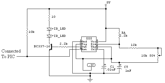

Below is the circuit I have assembled.
I have done these checks.
1. I see my IR LEDs in Mobile camera... It was ON, when i Pull Down RST Pin Down to ground LED Became OFF. (It means 555 working fine)
2. I check the frequency of 555 on oscilloscope and set it to 38.05KHz.
My IR transmiting LEDs and receiver on the same PCB.
I put a mirror infront of Transmitter. IR waves are reflected back but IR receiver Data PIN is still to High. It is not going to LOW.
But when I Press My TV's(SONY) remote button infront of IR receiver The date PIN oscillate between HIGH and LOW.... (I think it is right condition cuz Remote sending codes High and LOW)
What can be the Problem why Receiver not detecting wave created by my transmitter.

I suspect that your IR receiver is wanting the IR signal with a certain sort of duty cycle of pulses (pulse width) while your 555 probably is sending a 50% mark space ratio at the carrier frequency. I'm sure the data sheet for the IR reciever device should shed light onto the problem.

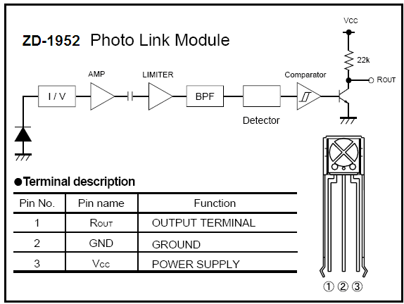

Somebody else showed that "surplus" ZD-1952 IR receiver IC. The store that sells it (Jaycar in Australia) doesn't know who made it and doesn't know if it is 30kHz or 40kHz or any frequency in between.
Maybe those IR receivers don't work.
The datasheet for the receiver shows it receiving the carrier turning on and off at about 833 Hz. Maybe it won't receive a continuous carrier since it is designed to receive data.

This "no-name-brand" IR receiver's datasheet doesn't say so but Vishay's TSOP lines of IR receivers have AGC that turns down the gain if the IR is continuous to reduce its sensitivity to compact fluorescent light bulbs that operate at about 40kHz continuously.

His 555 circuit cannot produce a 50% duty cycle. This will lower the sensitivity. Use one of the 555 circuits which will produce a 50% duty cycle, or, better yet, run the 555 at 2 times the receiver center frequency, and follow the 555 with a CD4013 D flip-flop configured to toggle (divide by 2). This way, you can adjust the frequency without screwing up the duty cycle.
EDIT: The only datasheet I could find (which Google points to, but the part number is not mentioned in the datasheet)
https://www.electro-tech-online.com/custompdfs/2007/03/ZD-1952.pdf
says data pulse widths need to be between 400 and 800usec, which seems to confirm what Audioguru said.

First i was sending countinous carrier(This was the problem)
Now i send data (just with pushbutton) and it is receiving data...
