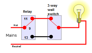

I have built a IR controlled light switch using the tsop 1738 IR sensor, 555 timer, D-flip flop (wired as toggle), and a 12 volt electromechanical relay. My question is how can I implement the use of a manual backup wall switch that allows me to turn the lights on and off but also still allow me to use the remote.
Essentially If I have the light turned on and then use the wall switch to turn it off, I should be able to press the button and the light comes back on. I've currently only been able to use the remote and it switches on and off perfectly, but when I try to include the wall switch as a backup I can't quite get it. I've tried wiring the light switch in series and in parallel with the relay. Any help would be greatly appreciated.
Something like this. One "3-way" (SPDT) switch is the manual switch and the other "3-way" switch is the relay contacts.

This is the way to do it you use both the normally open and normally closed contacts on the IR controller relay.
You will have to change the wall switch to a three way and add the extra wires.

Yes it is A or B only but it does not need an off it simply changes states from off to on or on to off, thats how a three way light switch works.
The IR is interfaced using pin (9,13) on this relay
. I send hot from the power supply to pin 13 (NO) and when the really is closed pin (9) becomes hot and is sent to the light bulb. Is it possible to use this relay and a basic physical light switch or do I need to get something special?
From the diagram above it looks like I take pin 11 and send that to the light switch and then connect neutral to the light bulbs existing neutral?
You need a three way wall switch no matter what, unless you wire the existing switch to another one of those relays.
The only way to have full control from two locations is to use a three way setup.
I added the relay pin numbers to the drawing, does that help?

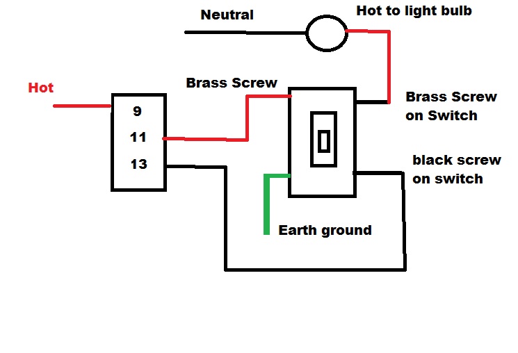

Okay so I've got the 3 way switch and based upon the picture that 4Pyros posted
300px-3-way_switches_position_2-svg-png.85699
this is the wiring schematic that I came up with. I just wanted to run this by the group before I actually implemented it incase I missed something.

This is the wiring diagram that I have put together based on what everyone has said.
Attached is the circuit diagram.

All most, The black screw on your new three way switch is common and should go to the lamp.
The two brass screws are the NC and NO that should go to the NC and NO of the relay.
Just so you know you could end up with a switch combination from time to time that leaves the relay on with the lamp off.
Its just the way the setup works.
