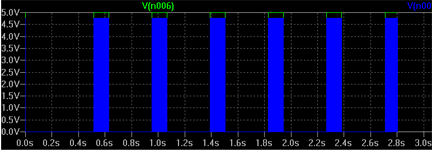

I think for that application the most effective solution will be a modulated IR beam and a matching receiver like this: https://www.vishay.com/docs/82463/tsop62.pdf
I believe it can be done with 555 technology for the modulated beam, but I used a simple PIC MCU. You will probably not need any reflecting tape
John
Edit: Just realized I simulated it several years ago:
If you have interest in that approach, I might actually have built the 555 version and can try to hunt it down.
  • IR_555.asc

Although not that actual component, I did try for some time with a similar version driven by a 555.
The problem is the nylon sprocket, even with the minimum clearance, is 20mm wide and at that range the results are very temperamental.
I've solved the issue using a HOA1405 with reflective paint in the slots, it works a treat, very stable and not affected by any ambient light issues.
