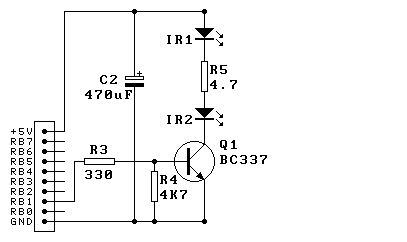

I found this on your site and is seems to be exactly what i need for the hardware part, i want to make it as simple as possible therefore i have tried to remove the reciever part does this look right?

I found this on your site and is seems to be exactly what i need for the hardware part, i want to make it as simple as possible therefore i have tried to remove the reciever part, does this look right?
