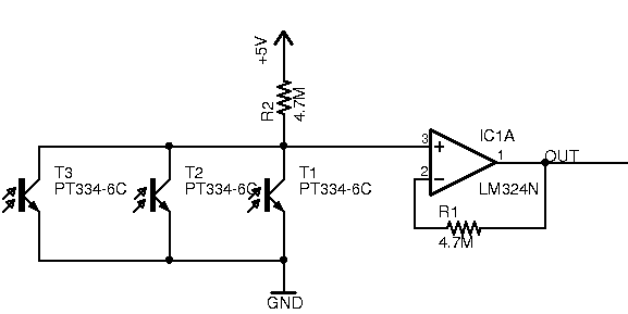

I'm trying to make this sensor work with any number of phototransistors in parallel but I do not know the equation for R2. When experimenting, I notice that with one phototransistor only, I get good results with R2 being 4.7M. When I add a few more phototransistors, I get good results with 470K resistor.
Eventually I'll be having 12 phototransistors in parallel in the same fashion as the three shown below and I'll also be connecting the output to an input of a 74HC251 IC for data processing.
The question is how do I adjust R1 and R2 given the number of phototransistors connected? and all phototransistors will be model PT334-6C and the opamp will be LM324N.

The datasheet for the phototransistor says that its maximum dark current is 100nA which is 0.1uA. Then 12 of them might produce 12uA.
You forgot to tell us the minimum output high voltage you want So I will assume 3.0V. Then the resistor must be no higher than (5V - 3V)/12uA= 167k ohms. Use 150k or 160k if the dark light is very dark and the temperature is not high.
I'm not understanding how you get 12uA. If each one is 0.1uA then 12 x 0.1uA = 1.2uA.
Then your future comment suggests I use 3.5V for logic high input since the output of the opamp is connected to a data input of a 74HC251. so (5-3.5)/1.2uA=1250k resistor for 12 units. and for 1 unit.... (5-3.5)/0.1uA=15M
Am I accurate here with my calculations?
Yeah, you are correct, the buttons on my calculator are wearing out.

The datasheet shows that the phototransistors cannot all be made to be the same. 0.1uA is the maximum dark current at room temperature and some have less. The sensitivity (the light current) also has a range where some are more sensitive than others. The value of R1 sets the sensitivity to light (a higher resistance allows less light to turn in the phototransistor but then the dark current might also turn it on).
You are using an old LM324 opamp that has PNP input transistors where a negative going input turns them on. Then when there is a small amount of light the phototransistor must supply up to 0.25uA (the maximum input bias current of an LM324) to begin turning on the input of the opamp so the sensitivity to light is much less than if you used a modern Cmos rail-to-rail opamp.
EDIT: Wait a minute, the sensitivity is very low anyway because the value of R1 must be low enough to cancel the black current from 12 phototransistors.
