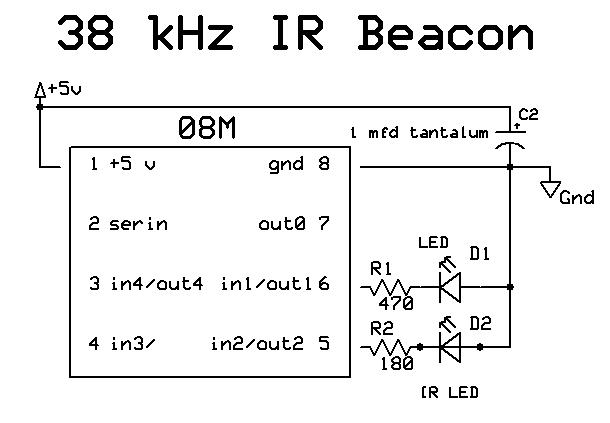

Hi..all..i'm a learner of electronics..so not having good knowledge of electronics..these days i'm trying to make IR gate
as a security gate..so i used this circuit..
At the beginning this circuit is not worked..then i was able to work receiver part..
but i 'm unable to use that oscillator part work..i have changed that values of capacitors as desire..some time i have seen that IR receiver response to the emitter..but it works for few centimeters..Another thing is i put additional ele.capacitor between output and ground of receiver sensor (before that output LED blinks only once i press TV remote)..it worked to me i don't know how it's happen..that means when i press TV remote in front of IR sensor that output LED of sensor get off..
so i need your guidance to implement this..what i want from you is..
can anybody tell me that
(1) how to make more powerful IR emitter like TV remote so that what IC should i buy for that..
(2)are there any Remote control IC for use for single button(that means single channel) to operate this kind of barrier circuit..
I'm really glad if anyone help me to make this small circuit..
I'm waiting response from you..
Thank you.......
IR transmission and reception is pretty well limited in its distance due to several factors, not the least of which is ambient light. The changers we use for TV are highly coded... first in their frequency of operation, and in the complex order of their instruction pulses.
As to the circuit you have shown, it would appear the author may have intended his circuit to be used as a proximity detector, which means the IR reciever detects light transmitted by the transmitter reflecting off an object in close proximity.
If you haven't done too much tinkering, you might be able to test this theory by adjusting the modules as shown on the circuit, then placing a white card or piece of paper a couple of cm ahead of the sensor. Reflected light should activate the circuit. Also, you should make every attempt to shield the recievers from extra light, expecially fluorescent.
I'm sure there are others who will give you their opinions on the matter.
Good luck.

Read the datasheet for the IR receiver IC.
It has AGC that reduces its gain when it detects continuous 38kHz IR which is interference caused by compact fluorescent light bulbs (and by your transmitter). The datasheet shows that the 38kHz must be modulated in bursts at a certain rate like a TV remote does. Use a second 555 to modulate the 38kHz 555 then the receiver's gain will be at maximum.
The current pulses in your IR LEDs is only about 39mA. The current pulses in the IR LEDs of a TV remote is about 1A. The 555 can supply only 100mA with its supply as low as 5V.
Your 5V regulator needs an input capacitor and an output capacitor. The 555 also needs a supply bypass capacitor and the IR receiver needs a supply RC filter that is shown in its datasheet.
The transistor will blow up from the high voltage flyback spike from the relay coil without a reversed protection diode across the coil.
