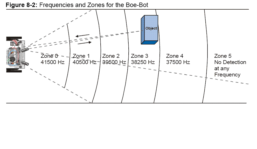

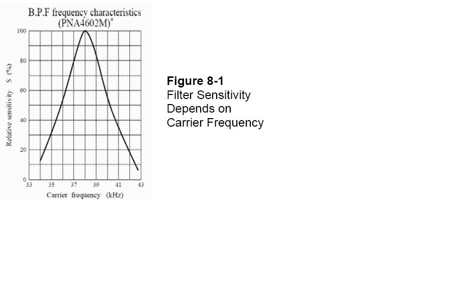

You can take advantage of the frequency response curves of the ir detector to create distance Zones. For example: the ir detector may be more sensitive at 37.5Khz than 36.5Khz ,35.5,34.5,33.5...and so on. For a full write up check out pg. 269 of the pdf located here.
Sig239: How about this? Do I need to filter the receiver part?
You forgot to say which IR receiver IC you are using so we don't know how good is its built-in bandpass filter. Most are pretty good. The IR receiver is the inexpensive but very sensitive ones used for IR remote control of TVs and DVD players.
