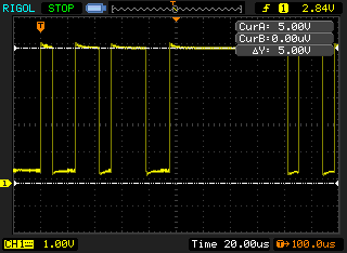

I took a picture of the correct, desired signal from the original USB serial adapter that came with my device ---
Unfortunately I didn't manage to get a picture of the output of the uC but it measures +3.3v, idle on high.

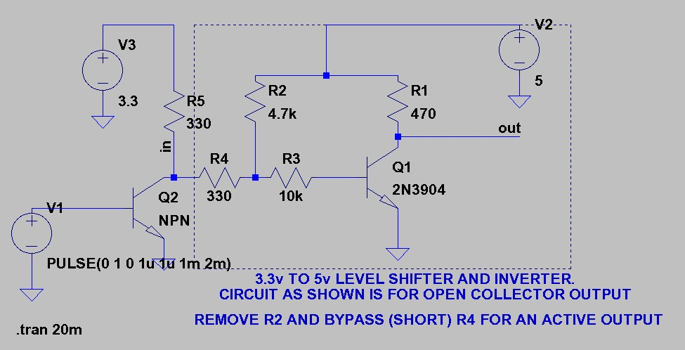

the level shifter shown within the dotted box is for a 3.3V OC output (with or without a pullup). for active outputs, you can simplify it by shorting across R4 and removing R2.LEVELSHIFT.jpg

I tried putting this together. The waveform looks perfectly like what I need in the oscilloscope, but the target device won't respond to this signal. Looks like I need to have an open drain or totem pole output for this to work, like in the drawing shown by unclejed613... but I don't fully understand it yet.
Thanks !!! --- But what's V1 for in this diagram?
V1 is a pulse signal used to drive the transistor that simulates your 3.3V device output. it's just a signal source used for part of the example.. it's not part of the level shifter. i will post the waveforms from the circuit in operation if you like, then you can see what's going on in it.
