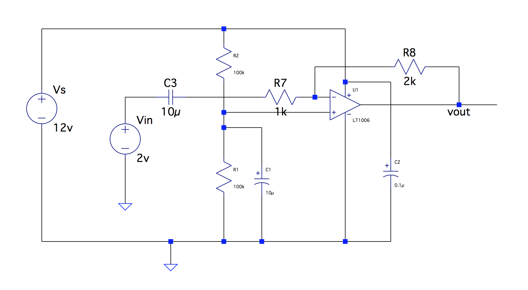

This is a schematic of the circuit I'm using. I've changed the parameters of the circuit and it doesn't matter what values I use I still get approximately vout = vcc/2, so there seems a fundamental problem with my design/construction of the cct.
For Vin I'm using a constant 2vDc source, however when I get the basis of the cct working correctly this will be adapted to function similar to a summing amplifierwith multiple "on" / "off" dc inputs.

Ah ha. Just as I suspected.
The 2V DC input is AC coupled through capacitor C3. That means that that DC input voltage doesn't exist as capacitors don't conduct DC.
What you really have is a unity gain DC op-amp with 6 volts at the non-inverting input. The gain is unity because R7 is is not terminated. So you get 6 volts out.
The circuit that you have is a valid AC amplifier. If you feed an AC signal in to Vin, then you will get an AC signal with twice the magnitude at the output of the op-amp. The output signal will be inverted, and it will be centered about 6 volts (the DC ref voltage feed to the ni pin)

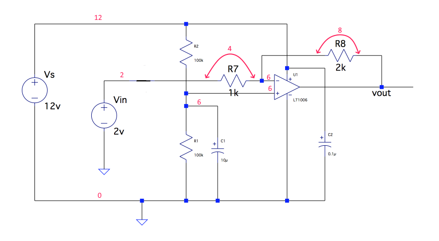

I removed the capacitor so DC will flow. As ChrisP58 said.
The (+) input is 6V.
The amplifier will try to make both inputs the same voltage. If it can.
R7 will have 4 volts across it.
R8 is 2x larger so 8V across it.
The output should be 14V. BUT it can not because the supply is only 12V.
