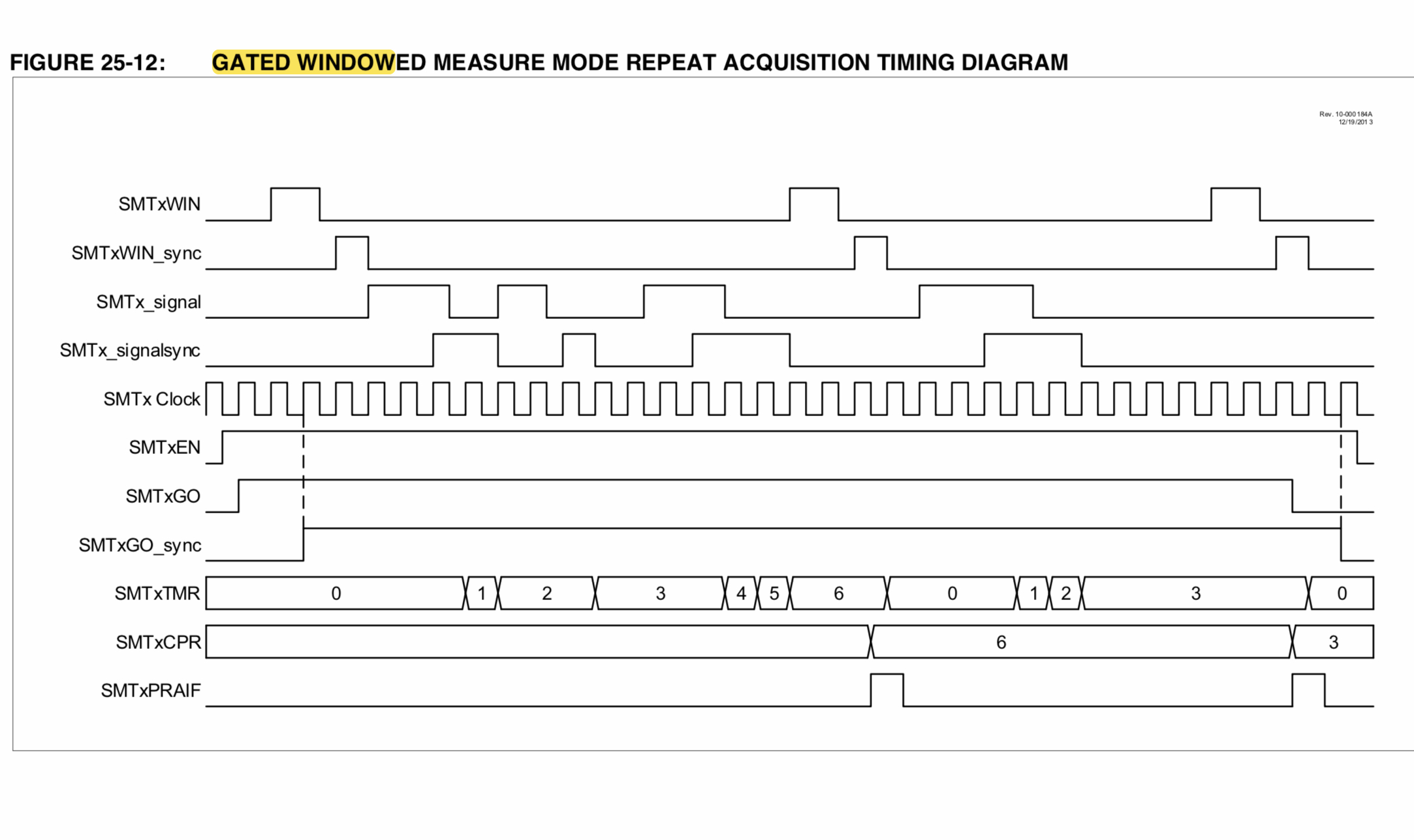

Another reason for moving to the 16F18857 (besides it saving an extra chip) is for the SMT (Signal Measurement Timer) hardware - as it has 24 bit range. Currently I'm using TMR1 (16 bit) and incrementing an extra variable every time it rolls over (it's all a bit 'messy') - essentially I'm measuring the width of pulses, which can vary over quite a wide range. Also, if there are no pulses for a certain time, then it decides all input has ceased and resets the reading to zero.
So the SMT looks ideal, clock it with 1uS pulses from the clock oscillator divided by four, and we get a nice range from 1uS to 16+ seconds, with 1us resolution - so I've been playing with it a bit.
Initially I was using it in Window Measure mode (measuring from falling edge to next falling edge), and feeding it roughly 1Hz it mostly read about 1000000 (as expected), but dropped down to 500000 or so periodically, presumably the same issue is affecting the SMT input?, and my previous 'work rounds' don't seem to help.
Anyway, next I tried High and Low Measure mode (independent values for mark and space) - and that seems to work fine, it displays 500000 or so for each of the high and low pulses, and altering the mark/space ratio makes the two values vary accordingly. Obviously I can simply add the two values together to get the total if I need the time for a full cycle.
Once I'd got that working I added another SMT interrupt, this one for when it rolls over, in order to zero the reading as before - this is also easy, as you can set the value it rolls over at to any 24 bit value - I set it to 15000000, so if there's no pulses for 15 seconds, it resets the reading.
So far it's looking pretty good, and the SMT loks a useful (if complicated) device.

I have never used the SMT, but as a result of this thread I was reading a little bit about it https://ww1.microchip.com/downloads/en/AppNotes/90003129A.pdf including an auto-calibration app note https://ww1.microchip.com/downloads/en/AppNotes/00002030A.pdf
