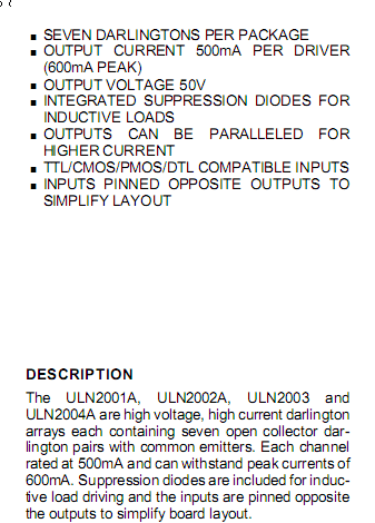

I am Interfacing stepper motor with pic using uln203a.
n i am giving supply to stepper motor as 12v.
but uln2003a is heating . what is the problem kindly help

How much current is flowing in the motor and ULN2003.?

current flowing betn stepper motor n uln 0.7mA..
Have you tried connecting 2 or more ULN outputs together in parallel.
A value of 700mA for one ULN driver output exceeds the recommended rating.
Look at this image.
The ULN2003 is a Darlington array correct? If that's the case then some heating should be expected, however ericgibbs is right. 700mA does exceed the maximum current of 500mA. Connect 2 in parallel and you should be okay.
ULN2803 would be a better choice for using with a small stepper motor. There is 8 darlingtons instead of 7 for the ULN2003. But at 700 mA, even paralelled, it is asking too much from this chip. Sooner or later, it will smoke specially if you try to run the motor full step for better torque, that being 2 phases energized at the same time. ULN2803 is pretty good for small motors rated at 150-200 mA per phase.

I would go with TIP120 Darlingtons transistors as power stage for your motor. At least you would have a lot of headroom.
