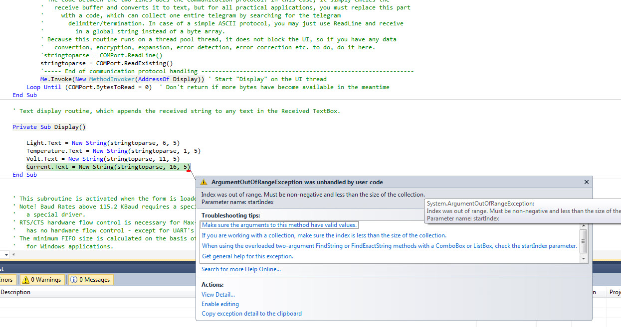

I get this error “Index was out of range. Must be non-negative and less than the size of the collection.
Parameter name: startIndex”
' Text display routine, which appends the received string to any text in the Received TextBox.
Private Sub Display()
Temperature.Text = New String(stringtoparse, 1, 5)
Light.Text = New String(stringtoparse, 6, 5)
Volt.Text = New String(stringtoparse, 11, 5)
Current.Text = New String(stringtoparse, 16, 5)

Should i install MaxiCOM.vshost in order to run/debug the MaxiCOM application for display of mentioned data?

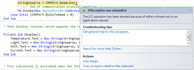

error
This is the error i get after Running/Compiling the program in VB2010.

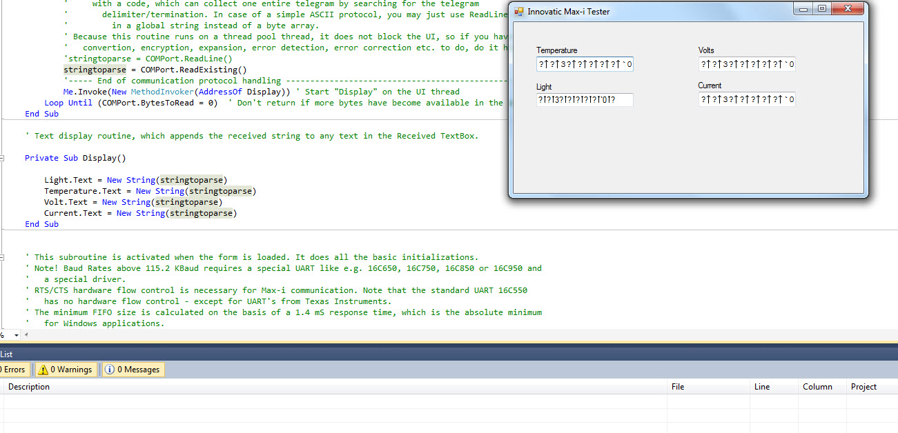

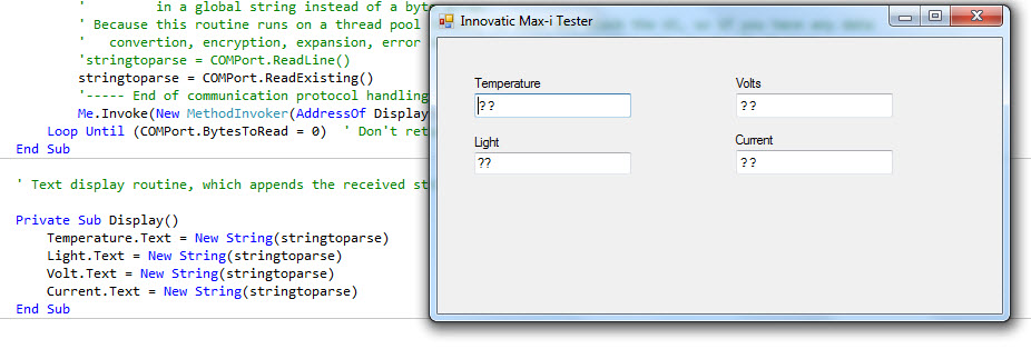

After changing
After changing
'stringtoparse = COMPort.ReadLine() to stringtoparse = COMPort.ReadExisting()
and
Temperature.Text = New String(stringtoparse)
Light.Text = New String(stringtoparse)
Volt.Text = New String(stringtoparse)
Current.Text = New String(stringtoparse)
End Sub
You can see within the snap the important codes and changes

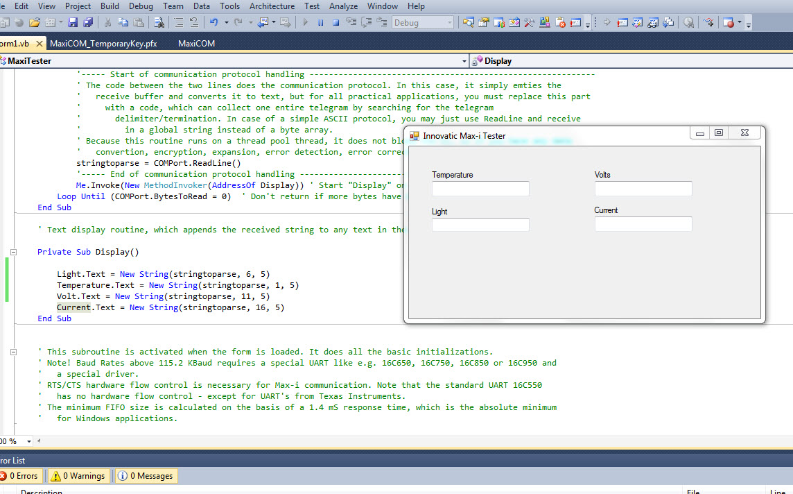

Put a breakpoint in VB at the readline() function and check the string that's being sent from the pic.
I know the code works as I have it running here.... I suspect there is a transmission issue... Using the mouse, run the cursor over ANY stringtoparse word and the tool tip text should reveal the contents.... IF!!! the breakpoint is never met... Then there is a transmission issue...Baud, Bits, wiring etc...

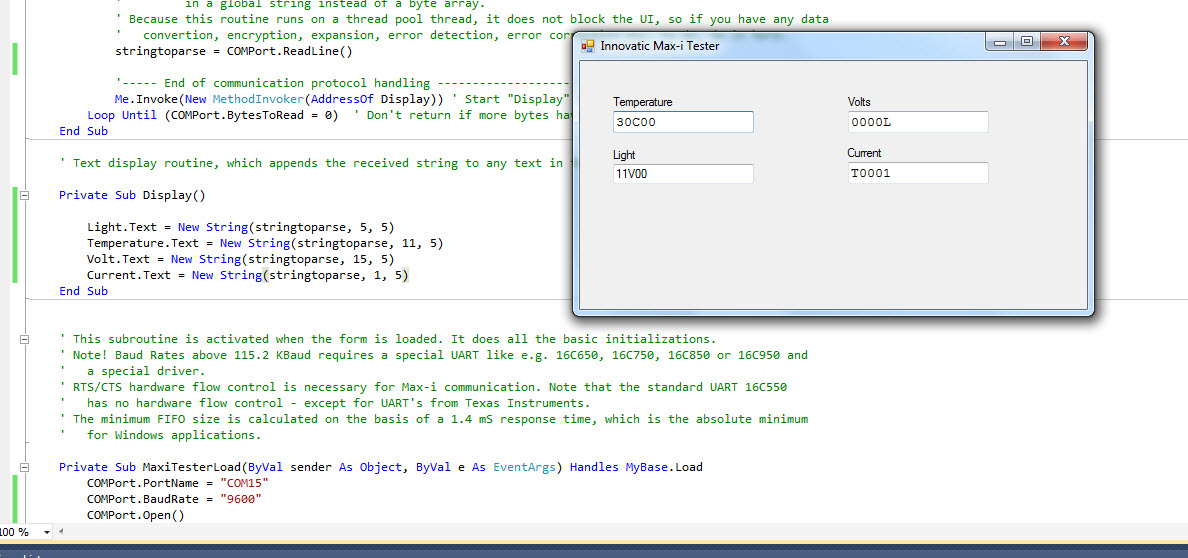

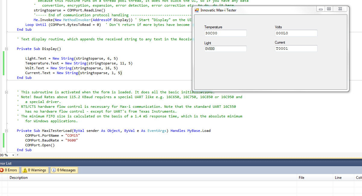

Answer) After correction it worked almost, Please see the snap i took just now after correction in the pic programme. It was so effective, because now at least something is displayed. but the values are not displayed correctly. e.g. the first digit of light is not shown.(but the data is coming from pic, because by changing the sensor value it also changes).
If you think comparing the real values from LCD by the values shown in VB can help let me know i will send you the snap of real values as well.
By the way i changed the order of followings since it was not showing in the correct box in VB2010.
' Text display routine, which appends the received string to any text in the Received TextBox.(I hope it is not affecting the objective)
Temperature.Text = New String(stringtoparse, 11, 5)
Volt.Text = New String(stringtoparse, 16, 5)
Current.Text = New String(stringtoparse, 1, 5)
End Sub

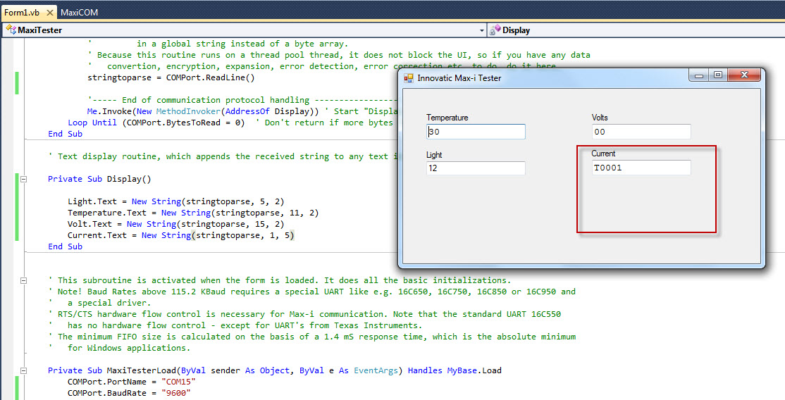

Yeaaaaa, The light is now OK!
I am just playing with these values to get something correct.
Light.Text = New String(stringtoparse, 5, 5)
Volt.Text = New String(stringtoparse, 15, 5)
................still changing with VB2010. update you Ian. These things .......haha
