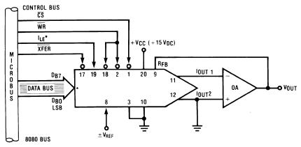

is there any way to inc the current comming out of the op amp? i am currently getting .3mA and 2V from the op amp , the op amp(LM 741) is hooked up from the DAC(0832). the op amp is hooked up as a voltage follower, i need at least 4mA , between 4mA to 16ma actaully..
i treid hooking it to a transistor NPN2222A but i got the same current out.
thnx any help is appreciated..

I think you had better post your circuit, there should be no trouble getting the current you need.

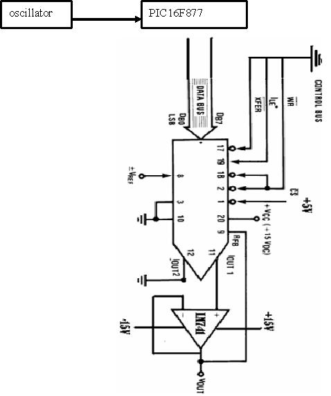

heres the digram...
thnx for the help guys..
jus need to find out a way to boost current.. to some where between 4mA n 16mA if i need to contol it.. i can probably use a pot later on :)

i get less amp that way
yes i tried it that way? but i only got 0.136 mA... so i had to try it into a voltage follower.. its kinda werid.. coz i was expecting more from the op-amp... the data that the dac is reciving is 1111 1111. so a full fledged thing... isnt there some sorta transistor resistor circuit that can boost of the current? or act like some sorta buffer?

I would suspect you have something wrong somewhere, the opamp is already a buffer - you shouldn't need to add anything else.
I'm also rather confused about 'only got 0.136mA', what are you actually trying to do?, and how (and why?) are you measuring the current?.
The circuit outputs a voltage, the digital number fed into the DAC produces a corresponding voltage at the output of the opamp.

But how (and why?) are you actually measuring the current?, measuring the current is generally done to see how much power a load is taking, you've never mentioned what load you are using.
If you're simply sticking an ammeter from the output of the opamp to ground, you're shorting it out and it's not going to work.

You need to measure the current into the load you're going to use - what is it supposed to feed?.

ne ways i tried a coupla different methods to amp the current such as current amp for opamp and transistor as a buffer and now we are using a FET (no avail) .the external power supply that i am using provied +- 20 and upto 0.5ma
that is fed into the DAC and op amp.
Tyron
I'm somewhat bemused by the power supply you mentioned?, you said the pump requires between 4mA and 16mA - yet the power supply can only supply 0.5mA, how do you expect it to work?.

I suggest you post your complete circuit, including the power supply, the current capacity figures you keep mentioning from your power supplies don't make any sense.
