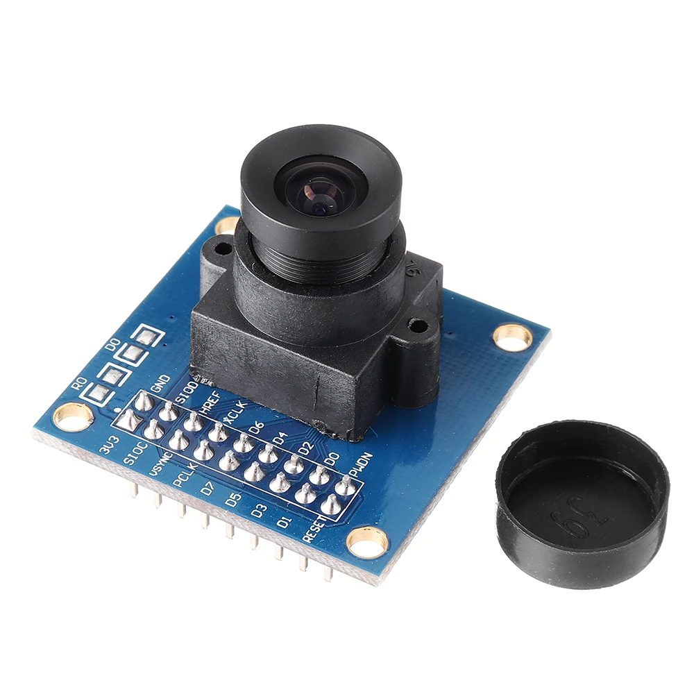

The 0v7670 is an option. I have not used it in 10 years so my memory is not good.
300,000 pixels and the 8051 might have 100 ram locations unused. That a problem.
I think the 0v7670 can be programmed to very low resolution. Then through away most of the data.
Watch out the 0v7670 is 3 volt and the 8051 might be 5 volt.

yeah actually I'm trying to use any camera like arducam, raspberry pi cam and then interface about three of such cameras to a microcontroller (AVR or PIC) to collect the image bit by bit every x-seconds and, process the images to send over the internet via a Wi-Fi module
Reading the responses, it sounds like he is trying to meet a challenge set up by his supervisor and 100 x 100 pixel resolution is enough - and "photo" is the goal, not streaming video.
The main aim of the project is to design a surveillance system that can take images every x-seconds and send the images to the user Gmail but my supervisor doesn't want me to use Arduino, raspberry pi, or even esp32 cam as he believes that will make my project process easy therefore he wants me to use microcontrollers to carry out most of the operations for the project to be more "technical".
It must not be 0v7670. Any camera without onboard Wi-Fi and Bluetooth modules will do.
Any DIP microcontroller will do because at the end of it all I will have to solder every single thing on a perf board rather than a PCB. In order to capture images at specific intervals, I designed a programmable timer using a microcontroller (Atmega8).
