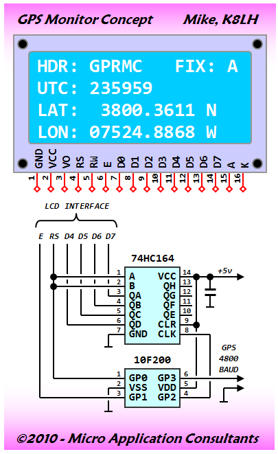

If it helps, I've got 10F200 assembly code that parses $GPRMC strings in a manner that mimics the following pseudo C code;
;  const rom char hdr[] = { "GPRMC" };
;  const rom char tab[] = { line1 + 5,          // HDR: ^
;                           line2 + 5,          // UTC: ^
;                           line1 + 16,         // FIX: ^
;                           line3 + 6,          // LAT: ^
;                           line3 + 16,         // card char
;                           line4 + 5,          // LON: ^
;                           line4 + 16,         // card char
;                           line1 + 5 };        // wrap
;  #define parser (field <= 6)    // parser on (1) or off (0)
;  void main()
;  { initmcu();                   //
;    initlcd();                   //
;    while(1)
;    { data = Get232();           // get gps character
;      if(data == '$')            // if new 'sentence'
;      { field = 0; ndx = 0;      // reset field and index
;        putcmd(tab[field]);      // set lcd 'ddram' address
;      else                       // not new sentence
;      { if(parser)               // if parser 'on'
;        { if(data == ',')        // if new field
;          { field++; ndx = 0;    // bump field, reset index
;          else                   // not new field
;          { if(field == 0)       // if header field
;            { if(data!=hdr[ndx]) // if not "GPRMC"
;                field |= 8;      // turn parser off
;            putdat(data);        // print char to lcd
;            ndx++;               // bump field index
There's obvious differences between what this code does (writing each character to the LCD as it comes in) and what you're trying to do (save each incoming character to an array), but if you think it might help to look at the project I would be happy to post it for you.
Cheerful regards, Mike
