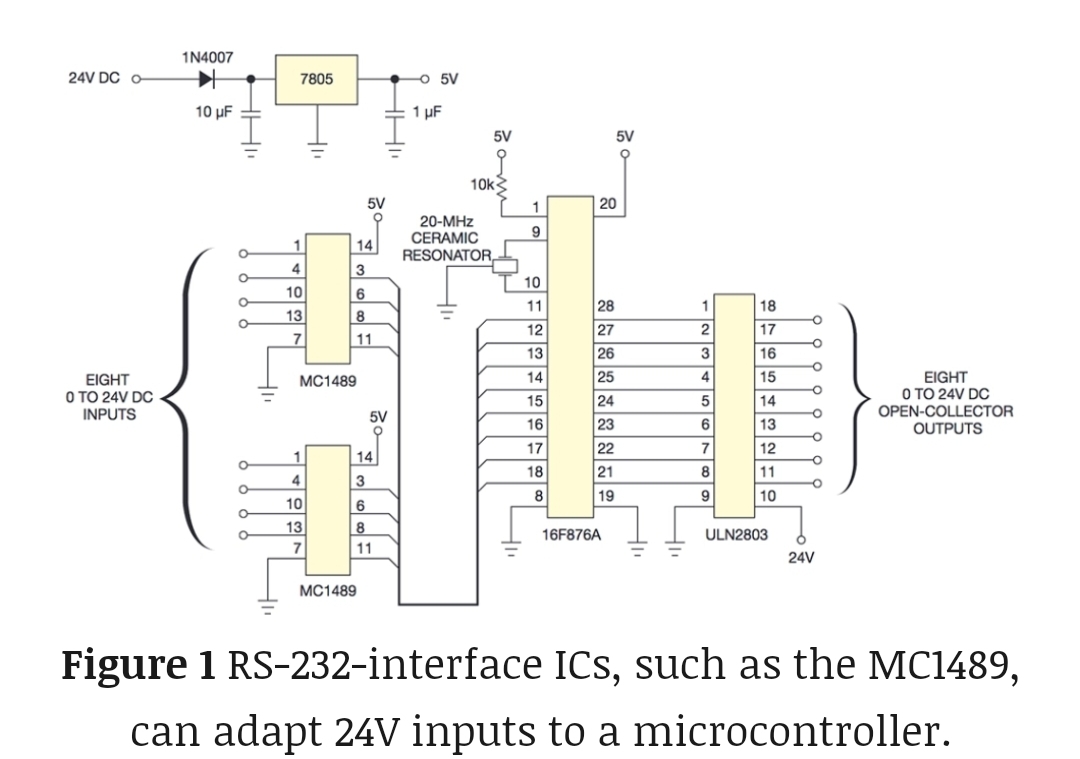

I have always favored the approach used in this EDN article:
**broken link removed**. It uses old-school MC1489 quad RS232 interface chips and will handle a wide input range of up to 30v. Unlike voltage divider inputs or optically-coupled signals, it handles a wide input range without any adjustments being required.

Something much like this will do the trick.
Thanks for the ideas, now to get cracking.
Thanks Again.
