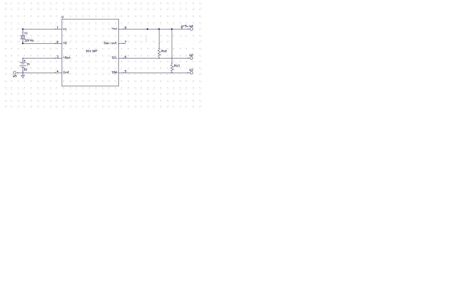

Interface of Pic18f8722 with RTC DS1307
engineerfaisal
// Project: //
// Header: 8722 Project //
// PIC used: PIC18F8722 //
// Start Date: 1st Dec 2009 //
// Function for I2C2 //
// the interface of DS1307 with Pic18f8722 //
// Backup power by lithium battery(3.3v) //
// Microcontroller is in master mode, I2c has been designed for 100Khz, //
// I have connected pullup resistors(2.2 Kohm Each) with the SDA and SCl lines, //
// 32Khz Crystal oscillator for DS1307 //
