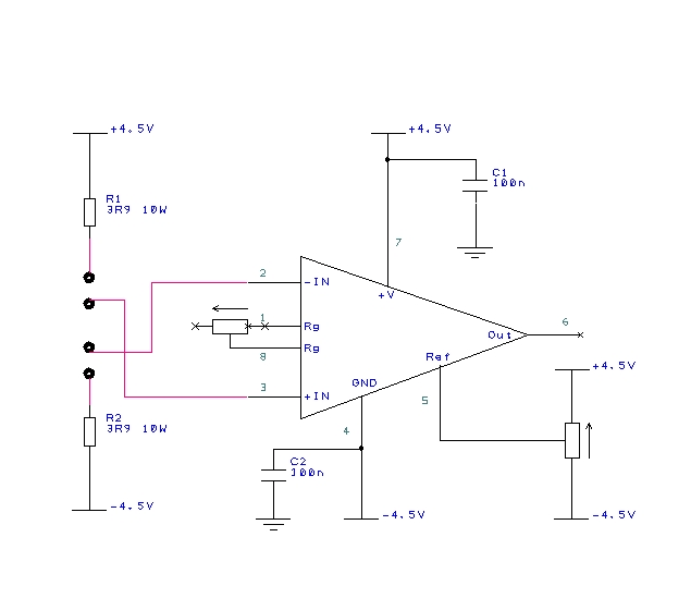

I am still struggling with with AD623 instrument amplifier a little.
In my circuit each input (2+3) is connected to a testpin, which is of course open if not in use (there is a 4K7 in front of each input as protection). The circuit works fine when in use, but when not in use the open pins catch lots of noise and I get an erratic output signal.
How do I tie the inputs down?
The input signal is in the upper µV range, or in other words, I want to measure the voltage drop on a very low mOhm range.

I fit a 10nf or 47nF capacitor across pins 2 and 3, choose a good quality capacitor.
The datasheet recommends a filter using the 4K7 resistors and the 10nF, this will reduce the noise into the AD623 amplifier.
So that your inputs are not 'floating' when not in use, I use a 2 pin jumper plug mounter on my PCB which I can short out the inputs.
Use the two pin plugs and jumpers you can find on an old PC card.
E
EDIT: Look at Fig 51 of the d/s for the option of using two 100K resistors to 0V, one from each pin 2 and 3.
