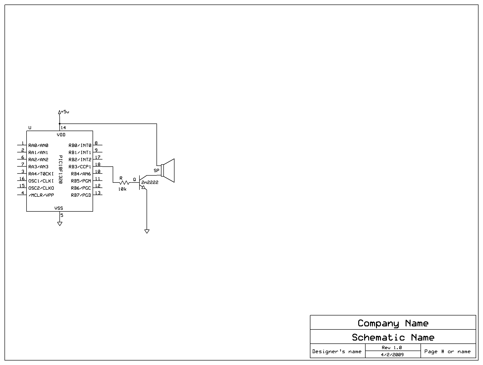

And the code for the melodies from the link you suggested, do I test using a speaker ?? or a piezo sounder.
If a piezo tweeter will work then I will tray and get my 2 - 6 khz frequencies??
lots easier than the method I was attempting.
can the pic do to frequencies simultaneous back and forth?? or would I be better off asking for all of Berni Madeoffs assets--lol

You can hook it up like this

The piezo speaker will have a sweet spot frequency where it's going to be the loudest.
Now RB.3 (or CCP1/PWM) can generate a frequency all by itself. It's a set and forget kind of thing.
