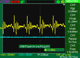

scope on plate says:
but is this just stray rf, i did get 60hz noise too?

:( definitely toast, i could not see any checkerboards though, but upon closer inspection i am able to see the bus in the ribbon, it looks to have a bus on the left, space, bus on the right, I will guess that this checerboard is much like a keyboard matrix, the phone is definitely toast, but i need to unlock it, so i can flip it to usb storage mode,
I just have this feeling that unlike a keyb matrix, this one is analog, so i would think to use resistors to close the circuit, but this is CAPACITIVE system, lol does that mean i should close the circuit with capacitors??
Mine mounts automatically in my computer when I plug it in with the usb cord, then you can copy the contents onto a backup drive. Maybe try wiring up two probes with a tiny capacitor between to try to activate the bus?
