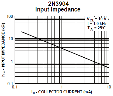

It's increasingly used to refer to the Raspberry Pi computer :). What does the 'p' stand for in connection with input resistance?
Your transistor has negative feedback from the collector to the base of the transistor when there is a source resistance. If the source resistance is very low then there is no negative feedback. The negative feedback reduces the input resistance of the circuit.
Fairchild's datasheet for the 2N3904 transistor has a graph of its input impedance vs its collector current. It is for a "typical" transistor that has "typical" AC current gain.

Yes I forgot to put source resistance in the picture.
I looked at Fairchild's datasheet for the 2N3904. It doesn't show how they wired it to get that plot,
but I gather that they just increased base current to get Ic.
And they did it across wide range.
My text talks about small differences in Ib, which makes input resistance almost a constant.
The transistor in the input impedance graph is a common emitter type with no emitter resistance. Of course the base current is increased to result in increased collector current.
The current gain amplifies the internal and external emitter resistance of the transistor.
The DC input resistance is hFE x (26/collector current in mA).
The AC input impedance is hfe x (26/collector current in mA).
input resistance would be Rin. the example shown above has a capacitor at the input, so Rin would be infinite. input impedance would be Zin, and would be finite, but frequency dependent because of the capacitor and interelectrode and Miller capacitances of the transistor.
