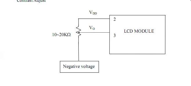

On the LCD, what is connected to pin #3 [VO], it should be a 'contrast' voltage'.
Connect a 10K pot across +V and 0V with the wiper of the pot connected to pin#3, by varying the pot you should see the 'pixel' blocks.
Hello Eric,
Thats exactly what I've done , a 10k pot between Vdd and Vss en connected it to Vo ( contrast input ) .
I also changed the resistance of the pot , but no succes .
when you turn the contrast up fully do you get anything on screen. you should have a row of blocks on the top row even if the screen isnt initialised.
Thats for the tip corbra . I get nothing :s . Not even a blink when turning on. Checked Vdd en Vss connection.

Hello Eric,
Your LCD d/s says a neg V to the bottom of the contrast pot, not 0V
You should see the pixel blocks.???

Hello Eric ,
I only have a +5V here. Hmm I'm going to look if I can make a negative voltage. I picked 2 battery's and checked it , the first row changed black :D

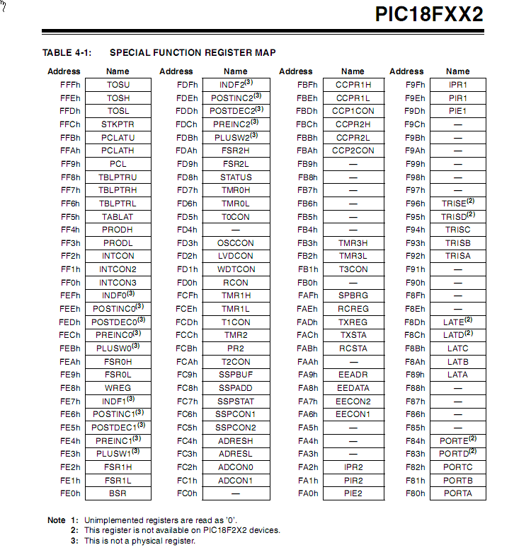

thanks for the ASM code , I'm having some difficulties with the instructions like " bcf 0xF81,6" , "movwf 0xF82" , weird instructions are used in that asm code :D.
Hello Eric,
They are SFR's special function register addresses, look at these two clips in order to get any conversion needed.
Hello Eric,
thanks for the clip , but that's a lot of work , I've got a pearson's education book of microcontrollers laying arround here. The code that is used there is almoust the same as my code . I've used the initialisation of the PDF for my ST7066 : https://www.electro-tech-online.com/custompdfs/2010/08/ST7066.pdf , page 20.
I applied this in my code. I think it's weird that I have to turn the display OFF ??? thats at the initialisation step on page 20 .
