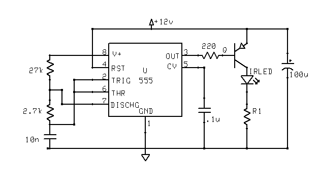

It has a rectifier and comparator to produce a high/low output. It could be improved without much change. Transmitter. Pulse the led at about 10% duty at a higher current. Receiver. Remove 100Ω and replace with short, remove 220pF, reverse diode polarity, swap + and - inputs of comparator.
Transmitter mod. R1 sets max led current. Leds which have 1A pulsed ratings are available.

Hi Fried,
That's a good idea to use a photodiode as a photo voltaic source, and the opamp with massive gain. Then you should remove the 2K bias resistor for it.
I think with a 9 percent duty-cycle it will sound low level and odd.

Was not refering to photodiode. Mean the diode on the output of the first opamp, so that it rectifies the positive going pulses, which will be of greater amplitude.
As an afterthought, if the TX is using 12v then several series leds could up the performance some more.
