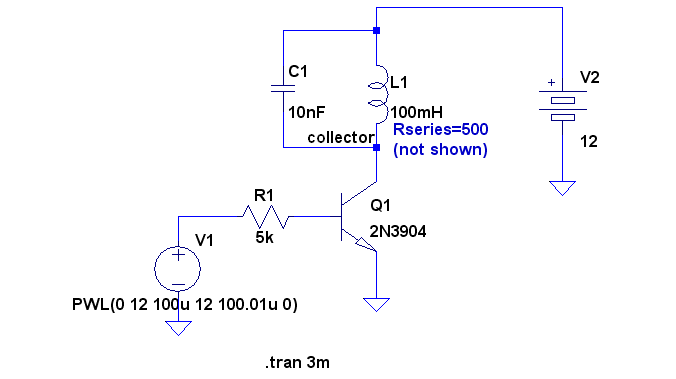

I have seen series RC snubbers, but a capacitor will resonate with the relay coil's inductance. Unless the Q of the coil at the resonant frequency is low, the voltage across the coil will ring, and could still break down the transistor.

Relay coils have significant inductance, but I have never seen it specified in a datasheet.
When the relay is de-energized, the coil current cannot change instantaneously. If there is no place for the decaying current to flow, a large voltage spike will be created. If there is an alternate path (diode, capacitor), the current will take that path. If the alternate path is a capacitor, the current will "slosh" back and forth between the coil and the cap, creating a damped sine wave. The frequency if that sine wave will be F=1/(2Π√LC), where L is the inductance of the coil and C is the parallel combination of the external cap and the stray capacitance of the coil.
BTW, the stray capacitance of the coil will almost certainly be sufficient to absorb the current until the "diode reaches conductance".
Thank you very much.
What will cause the current to become a sine wave?
I mean if you will solve a differential equation of a series RLC circuit, with initial conditions :
I_L(t=0) = Relay's_current
V_C(t=0) = 0V (if the switch is low side) or Relay's_voltage (if switch is high side)
Then you'll get a sine wave that its frequency is what you said?
If it does, whats the problem with that, as long as the sine wave is dying out?

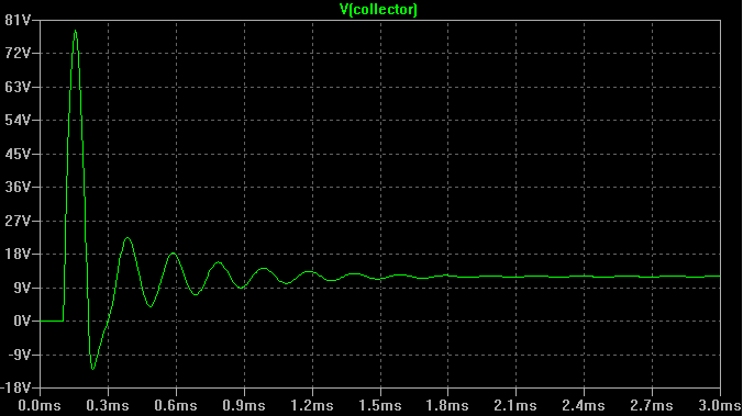

Here is a simulation. You will get different results, depending on the inductance and resistance of the coil, and the shunt capacitance.
In this example, the positive peak will break down the collector-base junction, and the negative pulse will break down the base-emitter junction.
I'm not saying the right combinations of parts won't work, just that you have to be aware of the dangers.
Anticipating a question: You will get the same results if the cap is tied to ground instead of Vcc.
I can't imagine why anyone would use a capacitor, when a diode is a much better solution.

The capacitor was the reason for seeing a negative peak on the Low Side switch?
How come please?
How come please?
Thanks for the great effort!
For the low side switch:
When the circuit "rings" (goes into damped oscillation), the voltage first goes positive, due to the fact that the current which was flowing in the inductor continues to flow - into the capacitor. The L and C (this is called a tank circuit) resonate, so the voltage waveform becomes a damped sinusoid, and thus eventually goes negative. When it reaches ≈-0.7V, the collector-base junction becomes forward biased, and the base resistor absorbs much of the energy that is circulating in the tank, distorting the waveform. Succeeding cycles of the waveform do not swing low enough to forward bias the C-B junction, so the decay in the sine wave amplitude is determined by L, C, and the resistance of the coil (500 ohms in this case).
Note that most Spice transistor models do not model breakdown phenomena. If they did, this waveform would look considerably different.
