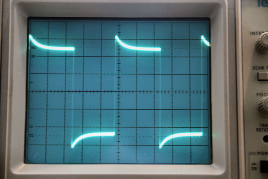

High Frequency Accentuation (Over Compensation)

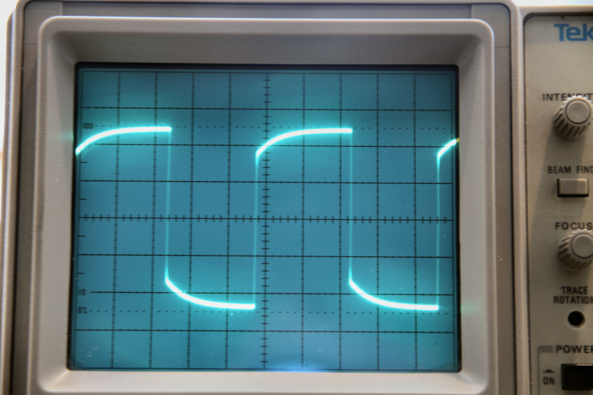

High Frequency Attenuation (Under Compensation)

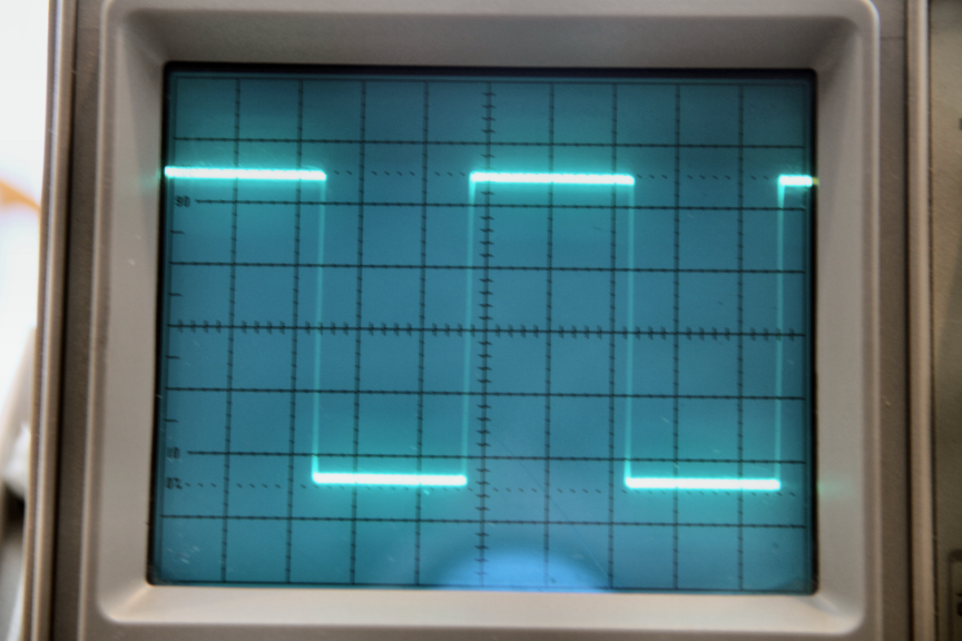

Correct Compensation
All 3 are the same waveform with only the probe compensation being adjusted.
