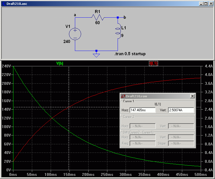

I found the time constant which is L/R = 0.15, I also found the current after one time constant which worked out to be 2.527A, I found the time for the current to reach 2.5A which worked out to be 0.147sec . The steady state value of the circuit worked out to be 4A (Vs/R)

The first 0.5s to see the time constant:

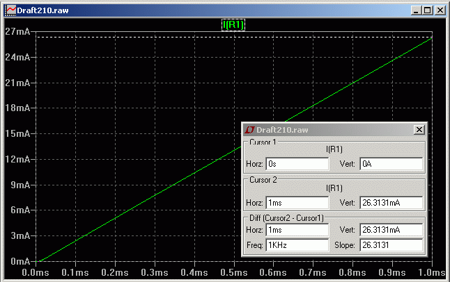

The first 1ms to get the initial slope:
τ=L/R is the 60% time constant.
i) Steady state is regarded to be 5x τau.
ii) dI/dt = V/L or 240V/9H=26.6666...
