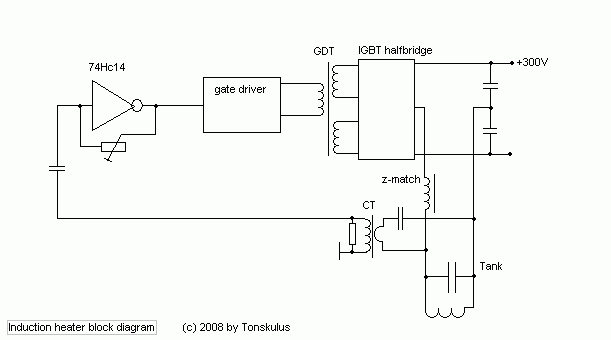

Here is the wschematic who inspire me.

Looking at the web page here:
High Frequency Induction Heating
In the section titled: The LCLR work coil
There is a suggestion that the series matching coil, apparently Z-match in your previous diagram, can be changed in order to match specific work pieces. Have you considered doing this? Is it effective?
Or do you want to achieve a circuit that is auto-correcting .... for different work loads?

Thanks for the site but already look and no real shematic or hint for my needs, but find this and i think that ITS my goal already drawn.
Really worth the visit.

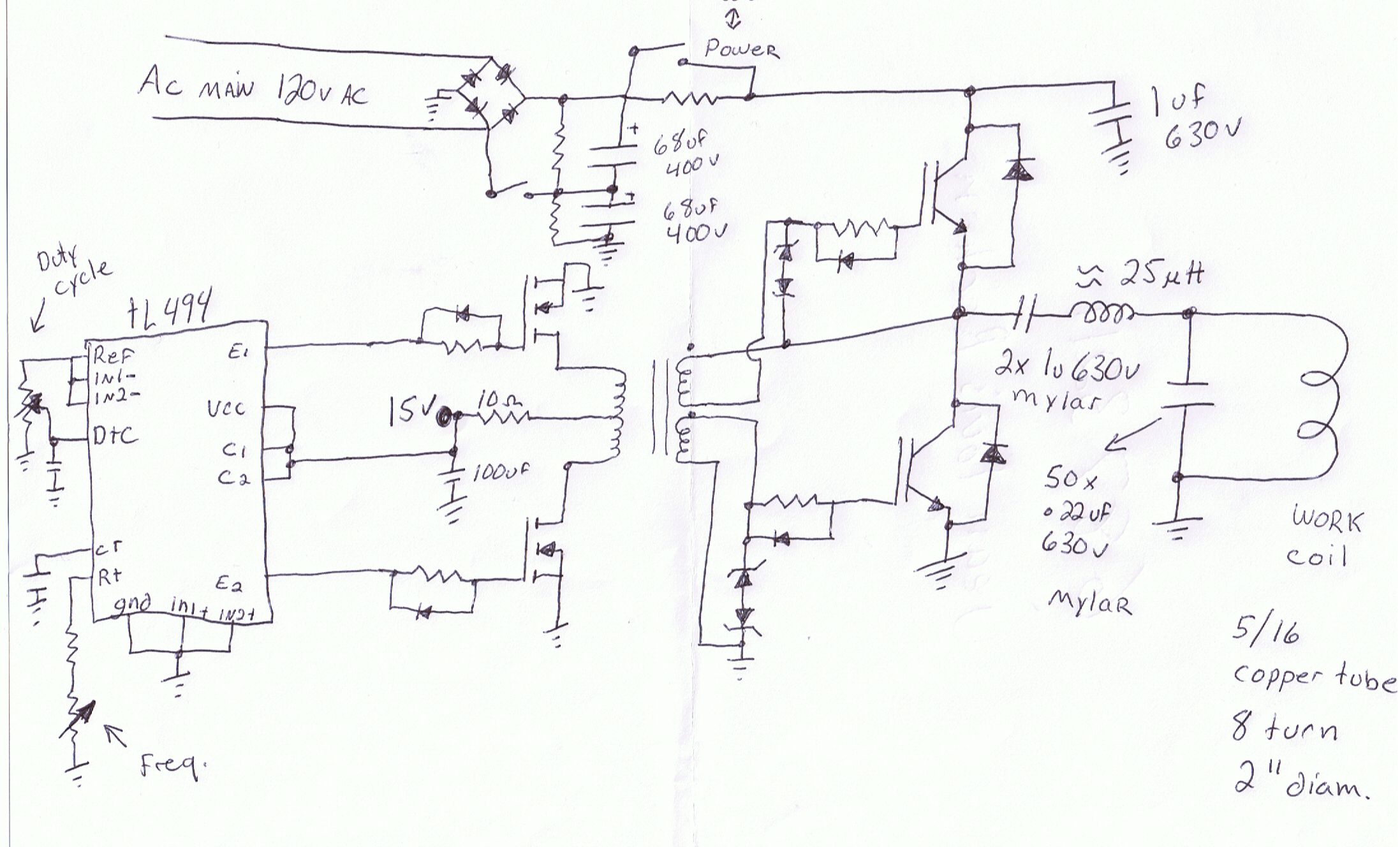

Heres is my own actual design that i will adapt in the next few days.
I'll be back soon to tell the story
So what is the basic principle of your own circuit?
You have a variable frequency PWM modulating the paired FETs on the primary side of the transformer.
Is the idea to manually adjust the frequency so that you have resonance on the secondary side?
The diode bridge gives you about 200VDC .... the current fed by the transistors into the resonant tank circuit... are those BJTs both bipolar npn type?
it may work but I would question if it will be able to tranfer enough power to even melt a aluminum pop can.

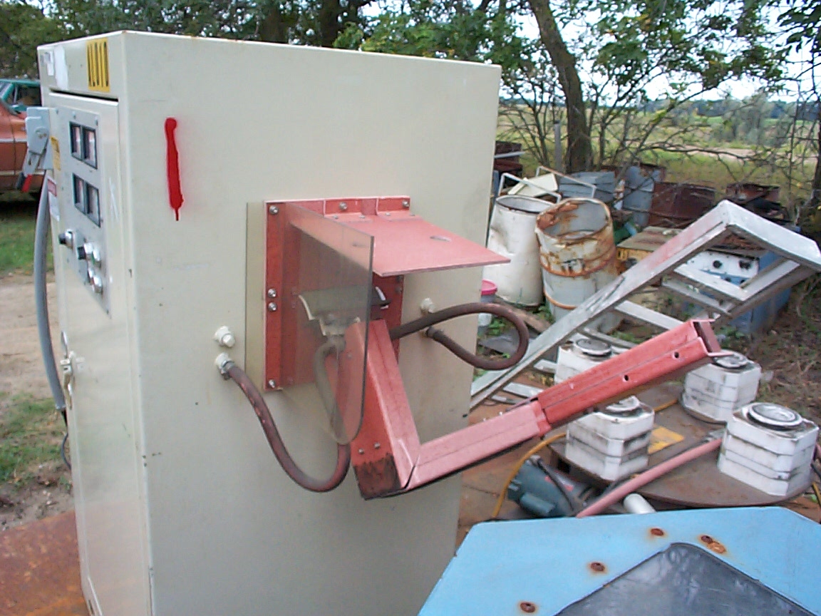

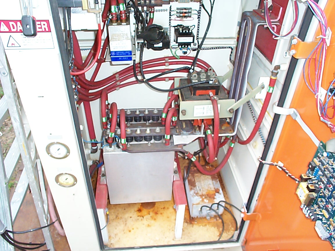

Heres some pictures of an actual induction heater. This one is 77 kw and runs off a 480 volt three phase source at 77 amps per leg.
It was only used to heat bushings that fit over shafts.
The bushings were about 2.5 inches diameter and 3 inches long. The shaft was about 1.5 inches diameter. heat up time was around 10 to 15 seconds as I was told.
Plus the unit is about 3 ft square and 5 ft tall. There is second cabinet that holds the liquid cooling system also. Total system wheight is around 1200 pounds.

those are IGBT handling 50 amps at 800V theres a switch that double the voltage giving almost 350 V at the bridge .
The 77KW is too big for me, i cast very small parts for robotic projects, i melt about 1 cubic inch of aluminium by heating a car caliper piston as a crucible.
I have to monitor the waveform with a scope to make sur its set at the resonant frequency of the coil+piston+aluminium. if not , the inverter heat a lot and destroy itself sometime if left unattended.
I'm learning from the site of my last post, looks like its more a phase matter than frequency to obtain max power automatically.
