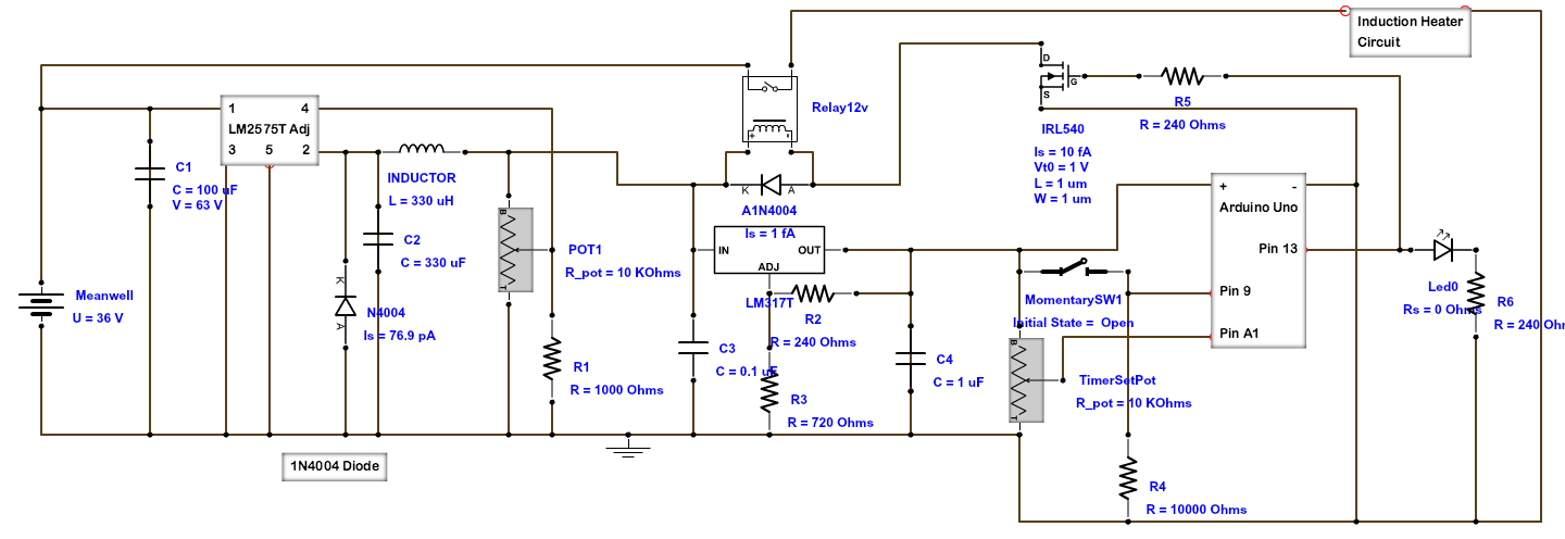

Hi Guys,
I am up to the next part in my induction annealer control circuit project.
I have run into trouble.
I wired up the circuit (Drawing attached. Sorry about the drawing. Free online circuit drawings don't allow some components, so I have drawn them as text boxes, hope that's ok).
When I plugged it in, Capacitor C1 blew up within 1 second.
The whole eprocess is meant to go as follows:
1 - 36V DC from the meanwell supply is feed to the relay contacts, to run the induction circuit when called by the relay
2 - The LM2575T Adj drops the voltage from 36V to 12V, so I can run the 12V relay coil
3 - The LM317T Adj drops the 12V power to 5V so I can run the arduino and other control components (Momentary switch, Time setting pot, LED, and MosFet which switches the 12v relay)
4 - The LED lights up and shows when the is power being supplied to the MosFet
The application for this circuit is basically a timer, controlled by arduino (and code).
When the momentary switch is pushed, 5V power is feed to the MosFet gate.
The circuit closes the 12v relay for a period of time.
This period of time is set by the timer set pot (up to 10 seconds, as an input into the arduino).
This allows the induction circuit to be on for that period of time.
Once the timer runs out, the 5V feed is dropped from the MosFet and the relay turns off, turning off the induction circuit.
I am very new at this.
This circuit is kind of a bit of a frankencircuit, as I grabbed all the necessary circuits I needed and put them all together hoping it would work.
It probably has some heaps of parasitic capacitance, or stray inductance or the like.
I just want to know why C1 popped (as it is a requirement for the LM2575 circuit), and how to fix it.
Thanks in advance guys.

The obvious question is, did you have the cap polarity correct?
If you did, then the cap could have been duff to start with, or the initial switch-on surge current could have fried it. You could try limiting the surge current with a resistor of a few Ohms, rated to suit whatever power you expect to provide via the 2575.
Look at the LM2575.
Cap on pin 2 NO it should be on the other side of the inductor.
Diode on pin 2. 1N4004. That diode is too slow.
R1 would be more useful in series between ground and the lower end of POT1, to restrict the adjustment range.

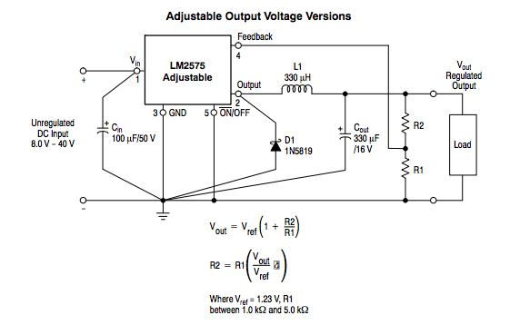

Ron - I rechecked the spec sheet for the LM2575, and it is the same I have have done it. I just used a pot for "R2" on the spec sheet, so I could vary the voltage out and get bang on 12V for the coil.
I have attached a screenshot from the spec sheet.
And diode too slow....sorry, not sure what you mean, too slow for what? (told you I was a noob)
Alec - I placed R1 there as R1 and R2(pot 1 in my case), are the resistors that specify how much voltage is actually comes out of pin 2, as far as I can tell.
If I placed R1 under Pot1 to ground, the wiper would be all that feeds back to make the Vout correct at 12V, and I will get a different voltage.
Thats my thought process anyways.
I might be wrong

As Ron says the output filter capacitor should not be connected to pin 2. (Only the inductor and flywheel diode sould be connected to pin 2 as shown on the data sheet.) The diode that you have used does not switch off quickly enough for use with a 50 Khz square wave. Use the specified Schottky diode or similar. The resistors do not control the voltage on pin 2. The output in pin 2 is a rectangular waveform with a high level almost equal to the regulator input voltage and a low level of about zero. (Actualy a negative voltage equal to the forward voltage of the diode.) The two resistors divide the desired output voltage down to the reference voltage (1.3 volts.) The comparator in the regulator changes the duty cycle (The ratio of on time to off time of the waveform on pin 2) to maintain 1.3 volts at pin 4 (And hence your disired output voltage at the output side of the inductor.)

What is the answer on polarity (post#2), and what type of capacitor is/was C1?
Note, if the capacitor is a tantalum, their voltage needs to be derated for high ripple current.

Your originl inductor although it is the correct inductance is not suitable as it's current rating is too low and its resistance too high.
The second inductor that you link to is the wrong inductance but one of this type of the correct inductance should be OK. An inductor similar to this would normally be used.
I suspect you have destroyed the LM2575 and it now has a short between the input and output (Pin 1 and Pin 2 ) I think this will be putting the full 36 volts input voltage across the 330 uF capacitor which is only rated at 16 volts.
I suggest that you start with the circuit exactly as in the data sheet and when you have that working make changes one step at a time.
Les.
Yep, I tested the LM2575....totally shorted between pin 1 and 2.

So just so I understand, the initial inductor was too high resistance and too low current capacity, it blew, and in doing so, shorted itself, which stuffed the LM2575.
So once I swapped out the choke type inductor for a toroid (actually I tried 2 x 150uH's in series, I forgot to mention that. I tried to get as close to 330uH as possible), the LM2575 was already stuffed and I was pumping 36V past a 16V cap C2.....dam it.

I do not think using the wrong type of inductor destroyed the regulator chip. (I am not certain of this as the fact that it would saturate may possibly could have destroyed the chip.) I suspected when you said that you had the 330 uF capacitor connected to pin 2 that this could destroy the chip as very large current pulses would be flowing through it. (But you now say it was not connected to pin 2 It was just your schematic that was wrong.) If you could be sure that your input voltage did not go above 36 volts then it would be cheaper to buy one of the step down regulator module that use the LM2596 from China such as this.

If you go the TI datasheet, starting around page 11 is a list of recommended/suitable components for the critical parts. There are also charts to help select components that need to be changed for your intended use. That is common for most of the "Simple Switcher" line. I recommend that you take TI's advice, if you want to build yourself.

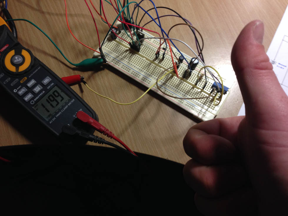

I got it working!! I went back to the drawing board, got all the bits together, followed it exactly...no smoke. I just must have had it wired wrong without realizing it? I dunno.
Guys you have been the most help!
Thanks so much.
