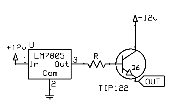

increasing output current of 7805...
ikalogic
i have searched the forum for similar threads but didn't find a lot,
how ever, i searched on google, and i learnt it's not good engineering to use 2 of them in parallel...
i found in many places a design that uses many transistors... or other deisgns that use ballas resistor...
now i am proposing this design, i'll try it tomorow, but before i damage my componenets, or waste my time... am i on the good track?
i expect the output to be more or less 5V..
also, what is a good value for the resistor for delivering say... 3A ?
thx guys

Hi, Kamal,
you get equivalent devices with 3 amps-- Google for 78S05

The supply included a 2N3055 mounted to a heat sink that appeared to function properly. I had an LM317 on hand so I wired it so that the 2N3055 was wrapped around it (sorry, don't have time to post schematic). I knew the LM317 had substantial ripple reduction capability but wondered how this arrangement would perform.
Tests were done with power resistors at 1 amp up to 3.2 amps. Ripple at the power supply terminals was less than 5 mv peak to peak. I measured the ripple just off the filter capacitor prior to the regulator and determined that this arrangement reduced ripple by a factor of 90 (39 db). Not as good as I'd like but acceptable. Waveform of the post-regulator ripple confused me for a moment until I realized that it was the result of the regulator's reactions. Only thing is that the output will sag 1/2 volt or so because of the voltage drop of the 2N3055 but that was ok in my situation.
This configuration might be described on a 3 terminal regulator datasheet. No power resistor is required.

Was the 2N3055 used as an emitter-follower of the output of the LM317?
Wrap around is used by the authors of the handbook I used (ARRL Handbook) though I can see where it doesn't tell the whole story. I'll have a look tonight to see if I can describe the arrangement better. While not the ideal approach it was quite the time saver. I only needed to remove the control board and replace it with perf board and the LM317. There was room on the front panel for a pot so I added the adjustment feature.
My first choice would have been an LM338 in a TO-3 in place of the 3055 but I would have to lift boxes to get to the collection I have - prohibited activity as I recover from back surgery. Next in line would have been an LM723 but the "wrap-around" a 317 was easy - and I needed something easy to do. I knew about the problems with it but they aren't a problem as a supply to my handheld transceiver. I could have used a 7812 but the adjustment feature is nice.

The "wrap-around" that I described yesteday is such that the output of the LM317 goes to the base of the 2N3055. The input (filtered DC +) of the LM317 is tied to the collector of the 2N3055 and the emitter becomes the new output. It's not pretty or efficient but it does work.

For what it's worth the authors also show a PNP pass transistor with a single power resistor that maintains the regulation of the 317.

Check to see if National Semiconductor simple switcher IC's are available where you live. They have several types such as the LM2576T-5.0 which is good for 5V@ 3A. They are much more efficiant than linear regulators, and only require a few parts to make them work, a coil a diode and a few caps. They also have online design software on their website to help you select the component values.

I agree heartily with Brevor - you *really* want to use a simple switcher from Nat Semi... one regulator IC, 1 coil, 1 low-esr cap, and a common-as-dirt schottky diode means it's *very* simple to build.
Not only that, but in a design I just did the 7805 needed a decent heatsink to dissipate the input voltage even when supplying low current (100-200mA), and now the LM2575 I'm using doesn't need a heatsink at all :)
Never mind that 2N3055's are in nasty TO-3 cases that need bigger than a matchbox heatsinks... the LM2575, coil, diode and cap take about 1 square inch of board space on a single-sided board :)
