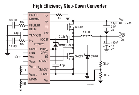

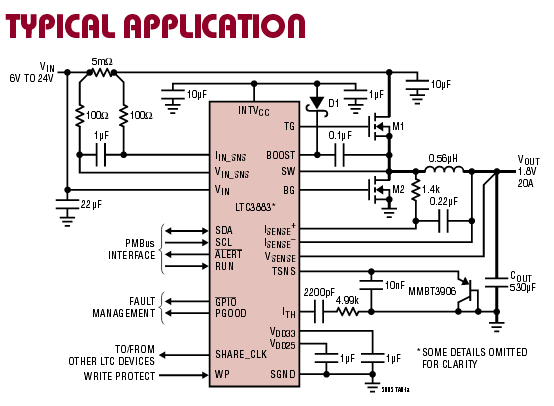

I would use a 24 to 48 volt power supply. Then buck down to 5 to 12 programmable.
If you use 12 or 11V supply then you will need to "boost/buck". Buck=5V and Boost=12V. This can be done but it takes more parts.
I could not find a good I2C buck IC. I will look more.
Something like this? The two feedback resistors could be replaced with a digital pot. The digital pot is controlled by the micro.

I was checking out their website, they have a lot of options for all sorts of applications. I am looking forward to building this. To power it should I just buy a 40V power supply or use a suitable transformer and diode bridge?
I find I can get a 24V or 48V or something "brick" power supply for good prices. I like the Idea the input is 110/220 AC and the output is 40V regulated and current limited. A transformer + diodes is not current limited and not regulated.
Sounds good, thanks for the help this route is way better then what I originally had planed. I was reading the datasheet and it seems pretty easy to adjust the voltage and current.
