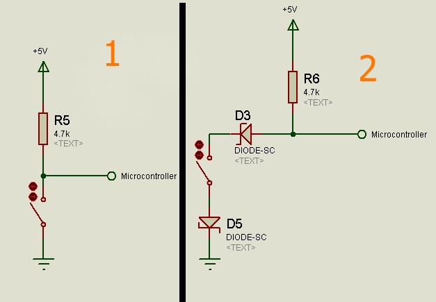

Which one is better?
is The diode in second circuit effect to reduce noise?
and the switch is connected with 20 meter wire.
I agree, that diode configuration is not sensible.

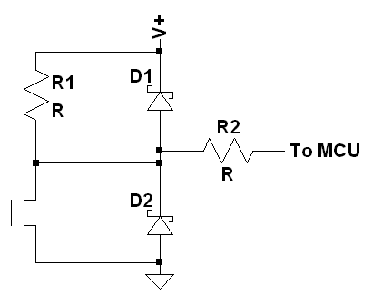

This would be the way to use diodes:
If you are measuring signals from equipment which may be at mains potential or higher you would isolate the micro (and yourself!) from that.
