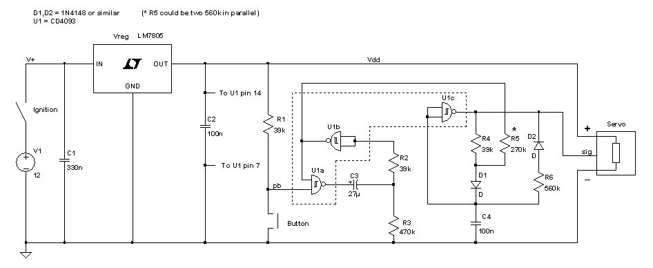

Hey there, i am new here so am not sure if this is the correct place to post this, plus i am typing this on a phone. So my project i have a problem with is this:
I wish to have a micro servo move 90° for ten seconds and then move back to its centre point after that duration and stay there until triggered again by a push-to-make button, the servo is to move a catch on my motorbikes rear storage box so it can be opened without the need to remove the key from the bike to open it, makes it more convenient and in a way a cool touch.
I have a Velleman PMK111'1 PCB interval timer as i was told it would be able to do exactly as i described but i have no clue how. There are no wiring instructions, only assembly instructions and I've already assembled the kit, so any help greatly appreciated as to how to wire it up if it will work fine or if i need some other board, i would rather have one board then several connected triggering each other as it would make reliability lower so the less separate circuits the better, plus got limited space as I'm on a bike and wish for it to be tidy.

Unfortunately the kit timer is unsuitable for your project. As it stands it just switches a relay repeatedly on/off/on/off/.... at regular intervals. It could be modified to provide a single on/off cycle in response to a push-button press, but would still not provide the signal needed to drive a servo.
If no-one else jumps in with a ready-made solution I'll come up with something to do the necessary.

No the kit really is not good for your application. It does not have a trigger input and so the switch would have to be left on for the timer to work. Maybe it could be modified with a trigger input.

If you're sure the micro servo has enough torque and is the standard analogue RC type here is a circuit which should do what you want.
With ignition on, but before the button is pressed, U1c generates servo-control pulses with a width of 1.5ms (corresponding to centre position). When the button is pressed a 10s timer, formed by U1a and U1b configured as a monostable, is started and U1b output, via R5, changes the pulse width to >2ms (corresponding to an extreme servo position). When the 10s expires the pulse width reverts to 1.5ms to re-centre the servo.
