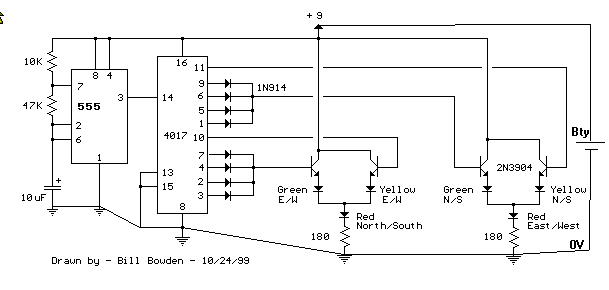

hi,:)
I have looked at these circuits, which one do you have a problem with, give me a project name.
hi 3v0.
Just in case.:)
Do you mean this.?

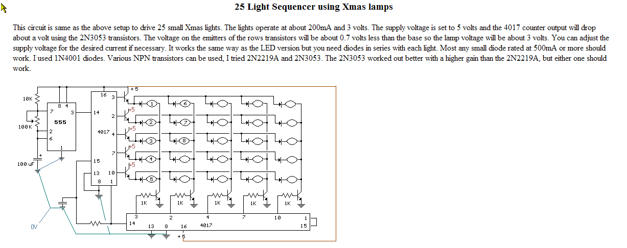

Thanks and sorry for this late reply:
I mean this circuit "25 light sequencer using xmas lamps"
Aditionally, I don't uderstand if the transistors (next to 555, right next to 4017) are connected even if at the draw the liaison seams to be interrupted...
Thanks again
the circuit of 25 light sequencer
The circuit is:
25 Light Sequencer using xmas lamps
Is the last one, if you enter the list of circuits and drag until the end...
Are the transistors next to 555 and 4017 connected in spite of seaming not connected completely?
It is a little confusing...
The five transistors arranged verticaly and to the right of the first 4017 should all have their respective collector terminal connected to +5V (like the top one)
In the matrix of lamps there are gaps where lines cross, these lines should really be continuous.
Where two lines connect togther there is a small dot at the intersection.
Pete
The circuit is:
Many thanks to all of you.
One last question:
the arrow, at the left side, it is directed to the resistor of 100k.
Is there any special reason for that?
In fact the lines are already connected with a dot...so what's the point?
Thanks again! (almoust everything understood!!)
does the circuit function with +4.5 volts? or +6 V?
I don't have 5 Volts...
I think the answer is yes...but
Thanks :)
One last question:
The resistor with an arrow is an adjustable resistor, a potentiometer. it varies the flashing speed.
It should work with 6v or 4.5V,
Just to confirm:
on the horizontal 4017 there seams to be a direct connection between 1 and 15...
is this ok?
Many thanks!
Just to confirm:
is this ok?
Many thanks!
That link 1 to 15 must be connected.
When the 4017 count gets to #6 it resets the 4017 to restart.
