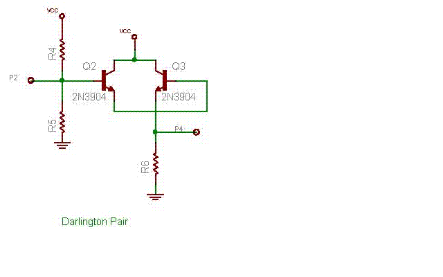

That's what it sounds like to me exactly. Everything Hero said. Might I suggest a Darlington amplifier. What that will do is provide a stiff current source. I will not load down the signal generator and it will step down the impedance to your transformer.
edit*
Try 100K for R5 & R6 and about 470 for R7.

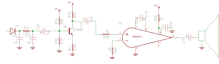

Hi Space Varmint. I have an audio amp I'm going to use. I bought it as a kit because the chip on it has a good gain bandwidth product (LM3886). I can't do much with it while i'm waiting for a bought power supply. I think Hero has hit the nail on the head too.
Thanks.
Thanks.
Oh, you need to speak with Audioguru. But I don't believe you need a transformer. Let me cut a piece of schematic out that I use for a related chip that works quite well. Be right back...
