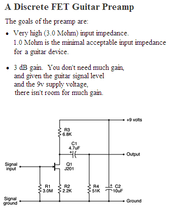

A guitar pickup works best when feeding a very high impedance preamp. There is a FET preamp on the internet with an input impedance of 3M ohms. the output of the preamp can feed your pedal.
Your Peavy amp is stereo (two channels). Since a guitar is mono then simply connect the two inputs of the amplifier together.

Hi audioguru,
Thanks for that, i see they use a J201 FET, i only have MPF102 & 2N3819 FETs at the moment, looking at the data sheets i don't think there suitable?
I will have to find some.

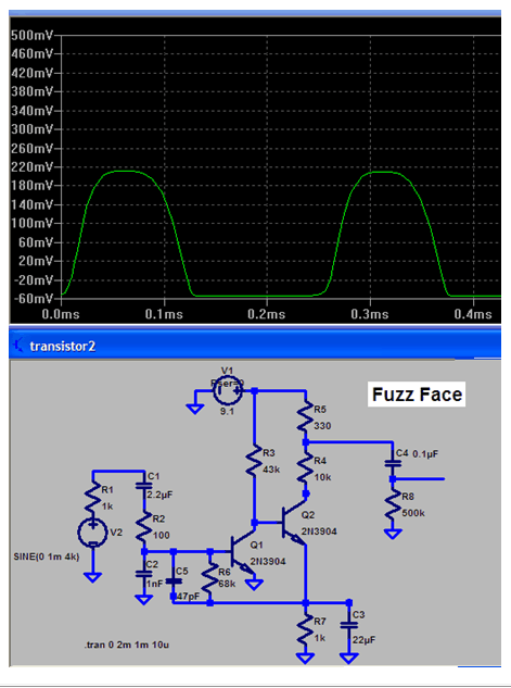

I was searching some older posts & found a Schematic you posted, i have attached it.
I have attached the ASC as well as i can't seem to get the circuit to simulate as you did?
I added an 8 0hm load resistor, not sure if that's correct, obviously i am doing something wrong that i can't work out?
Thank You
The guitar preamp circuit can use just about any FET.
If you have the time, ok if you haven't, could i bother you for an example or an LTspice simulation of how the newer Amps Clip compared to how the older Tube Amps Clipped.
I have never seen a simulation of an old vacuum tube amplifier. Just measurements. they have poor low frequency and poor high frequency performance. They soft-clip.
(Re: The Fuzz-face circuit) I added an 8 0hm load resistor, not sure if that's correct, obviously i am doing something wrong that i can't work out?
The circuit cannot drive an 8 ohm speaker because it is not a power amplifier. It drives a power amplifier that has a high input impedance then the power amplifier drives a speaker.
Test the simulation without the 8 ohm speaker. The 500k resistor is actually the input impedance of a power amplifier.

----"The circuit cannot drive an 8 ohm speaker because it is not a power amplifier. It drives a power amplifier that has a high input impedance then the power amplifier drives a speaker.
Test the simulation without the 8 ohm speaker. The 500k resistor is actually the input impedance of a power amplifier."----
I get it now, the strange thing is that i tried it with & without various load resistors & LTspice just showed a very erratic output waveform?.
I tried it without the 8 Ohm resistor this morning after restarting the computer & now i get very close to a squarewave form--Attached. Certainly very different than your result?

Your input level is much higher than mine (100 times more?) so of course your output is a saturated square-wave.
The value of the output capacitor is calculated for a 500k ohms load. With only 8 ohms for a load then the output capacitor passes only the high frequencies which messes up the waveform at lower frequencies.
Hi audioguru,
That's where i was getting confused, i was using a 100mV signal, that being the average ouput from my pickups.
So, the output from the pickups has to be regulated at 1mV for the circuit to function as designed, do i have that correct?
The LTspice sim works now i have reduced the input signal.
I breadboarded the FET preamp circuit you suggested & tried some different FET's, it works nicely & has nice sound, an improvement over the original sound output from the guitar, it's nice.

There is an article about the Fuzz Face circuit on the web.
At low levels it has low distortion.
At higher levels it clips but not symmetrically (so the fuzz is even and odd harmonics).
Then at higher levels it changes the sound.
