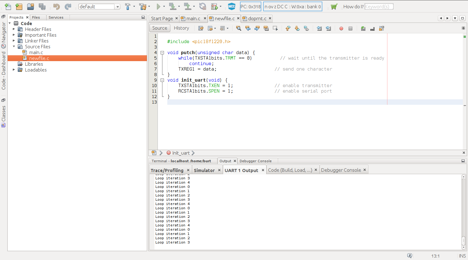

You can't have the new 4.00 with your older 3.xx Mplab x it messes them up But on a side note I figured out how to get UART 1 output working in Mplab x so it's all good
and Mplab X like linux I think better then windows.
Figured I share this with you I'm sure not all of us no we can output serial using debug in MPlab x
Needed code to make it work
#include <pic18f1220.h>  // make this the chip your using and look at the rest to see if the bits are right
void putch(unsigned char data) {
    while(TXSTA1bits.TRMT == 0)          // wait until the transmitter is ready
        continue;
    TXREG1 = data;                     // send one character
void init_uart(void) {
    TXSTA1bits.TXEN = 1;               // enable transmitter
    RCSTA1bits.SPEN = 1;               // enable serial port

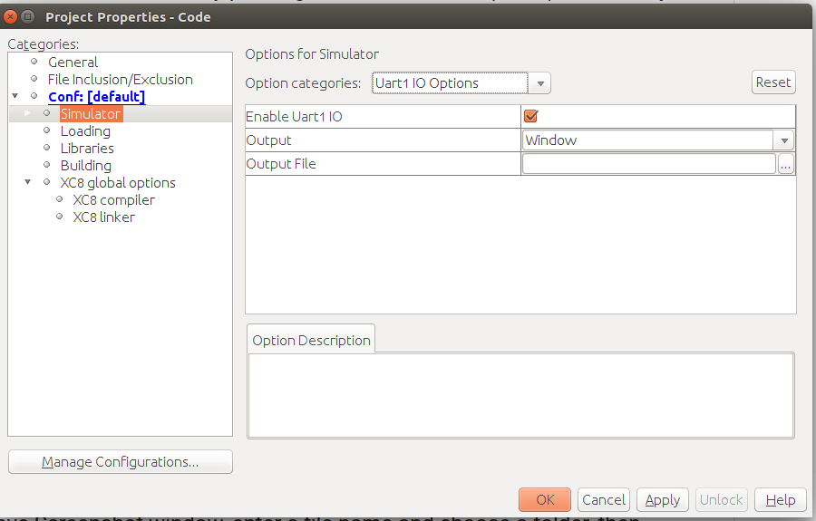

Open this window and set to use UART1 io option
use code like this to spit it out
#include <xc.h>
#include <stdio.h>
// Application begins here
void main(void) {
    init_uart();
 int i;
for (i = 0; i < 5; i++)
        printf("Loop iteration %d\n", i);
And have fun
