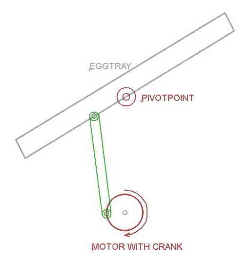

Never heard about leverage connected to a motor letting the load swing left and right?
There is absolutely no need for an H-bridge or something similar reversing the motor!
Use a grill drive with the appropriate leverage and let it spin day and night.
You'll probably create dancing chicken applying that method.
Boncuk

Boncuk,
You have a good idea but it might not be practical for him to rock the entire tray.
He's using string to pull it back and forth so he could use a similar mechanism to pull each string alternately.
If the eggs don't suffer from constant movement, perhaps a similar setup to a vehicle wiper-linkage could work?
Obviously, the motor would have to be geared down/replaced, along with calculating the distance from the wiper arm spindles to get the correct amount of travel, but there's an almost-ready solution possibly waiting in a junkyard somewhere.....for very little outlay.
