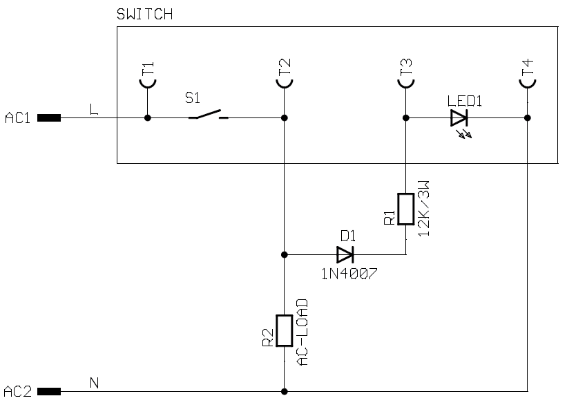

Hi all, I am building my own control panel for my pond, it will switch lights, pumps, heaters etc.
I have today bought myself several Illuminated locking push switches.
Maplins N05AR.
I am a little baffled. There are 4 conections on the back of the switch, 2 are for the 240ac in and out, but two smaller ones for the LED inside the switch.
It states that the LED 2ill come on at 2.4v DC.
How an earth do i wire these up? do i have to have a seperate power supply for the LED or what? It seems a little strange that a switch would have a seperate power supply for the led.

You can power them by putting a diode and resistor in series with each LED to the 240AC (the diode is to block the reverse voltage). For a typical 20mA LED current this would require a 12kΩ resistor. The resistor power dissipation is rather high so it needs to be rated at least 2.5W.

Thanks for the replies, I would be happier to illuminate them, when the switch is in the ON position, so im thinking (crutschow) idea may work better.
Is there any chance of a small wiring diagram crutschow?
It would help me understand the set up alot easier.
Im sure getting hold of the resistors and diodes would be easy, Is there any particular diode i need?
So I understand, its ok to use the 240V supply on the switch to power the led as long as i have a resistor and diode in series to the led? Do i need a diode on both sides of the led or just the + side?
Sorry for the questions, maybe a diagram would be easier to understand.
Thankyou for your help so far
Paul​
I guess that's what Carl meant:
T1 through T4 are the connections of the switch. AC passes the switch from T1 and T2 supplying the AC load (R2). When "L" leaves T2 it splits into the load and the diode-resistor-combination to supply the built in LED. Return path for both, load and LED is "N".

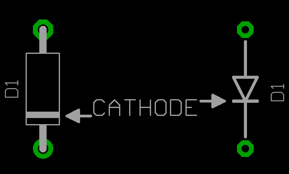

One more question is there a tutorial on how to recognise which way around the diodes and resistors go. I know which is first and second in line but they look very similar either way around. i.e If I was to flip the resistor it would look similar. Just the coloured lines slightly different.

Hi Paul,
a resistor is a non-polarized component. Orientation is up to you. (Good practice is mounting them with the colour code reading the value from left to right (tolerance colour ring silver or gold (sometimes brown or red) to the right side and top to bottom on printed circuit boards. Arabic electronic engineers mount them from right to left. :) )
Since you will certainly solder the parts directly to the switch it doesn't matter.
Diodes are polarized components. Orientation depends on the circuit design. The attached drawing shows a diode, left hand side the part and right hand side the schematic symbol. The bar represents the bar stamped on the diode body and indicates cathode.
Fuses should always used "in front" of the circuits to protect the entire circuit. In your case the fuse should be placed before T1

Thankyou very much for that diagram, very useful.
