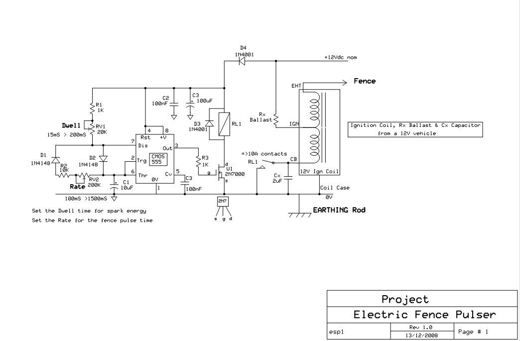

This circuit gives approx 10KV at a 1 second rate.
The circuit must be connected to EARTH to close the fence loop.

Two of the version I posted have being working on a farm in South Africa for about 5 years, keeping stock animals confined.
I chose a relay drive, because of the very strong and frequent electrical storms in that area, a long fence post makes a great lightning conductor and the MOSFET drivers used to 'pop'.!

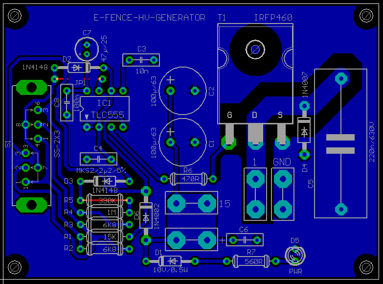

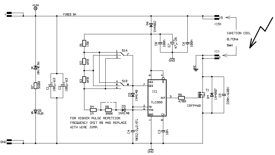

Hi tezza1,
if you have problems creating a PCB from Eric's design you might want to use my design.
It uses a car ignition coil designed for electronic ignition.
The power generated depends on the slide switch position and varies between 250 and 450mJ. The pulse repetition frequency might be increased by shorting out R5.
I recommend using the circuit battery buffered (30Ah car battery).
Boncuk

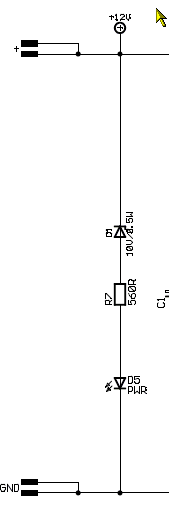

hi Hans,
Check this part of your circuit, the LED current.??

hi Hans,

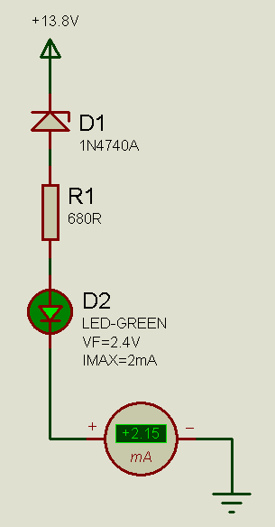

Hi Eric,
that part of the circuit is OK. The LED current should be 2mA for a low current LED. Using a battery charger (13.8V) the resistance value should be increased to 680Ω at which a low current LED 2.4V/2mA with draw 2.15mA. Using 820Ω for current limiting the LED will stay dark.
The LED to be used is contained in the circuit description.
Regards
Hans

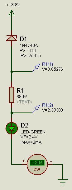

Hi Pete,
I don't know where you took 3V off. The LED is labeled 2.4V/2mA.
Here's a simulated circuit showing the voltages across each part.
Boncuk

hi Hans,
At 13.8V I agree with your results.
Pete, The 10Vz zener is not reversed.
My query was that
with a 12V supply as posted, the LED has only a 0.4mA current.!

I thought the zener was labeled 10 volt, meaning 3.8 volt would go to the led.
The eyesight might not be so good and i read the rating wrong.
Pete.

At 12V supply voltage it's advisable to use an 8.2V zener diode.
Anyway, I don't suggest to run the circuit off battery power. The ignition coil draws approximately 19.7A at 13.8V supply voltage.
At a pulse repetition frequency of 1Hz (normally 0.667Hz) and a pulse width of max 31.5ms (minimum pulse width is 16.5ms) the battery would be depleted pretty fast.
So I suggested using battery buffered operation - with the battery being charged on demand.
Just to add: The dual 3-position slide switch is put in for proper function under all circumstances. If the timer circuit fails due to bad contacts of a single pole switch the timer output might go to steady high output burning off the transistor and/or the ignition coil. So a 5A fused supply for the ignition coil eliminates the need for new parts every once in a while.
