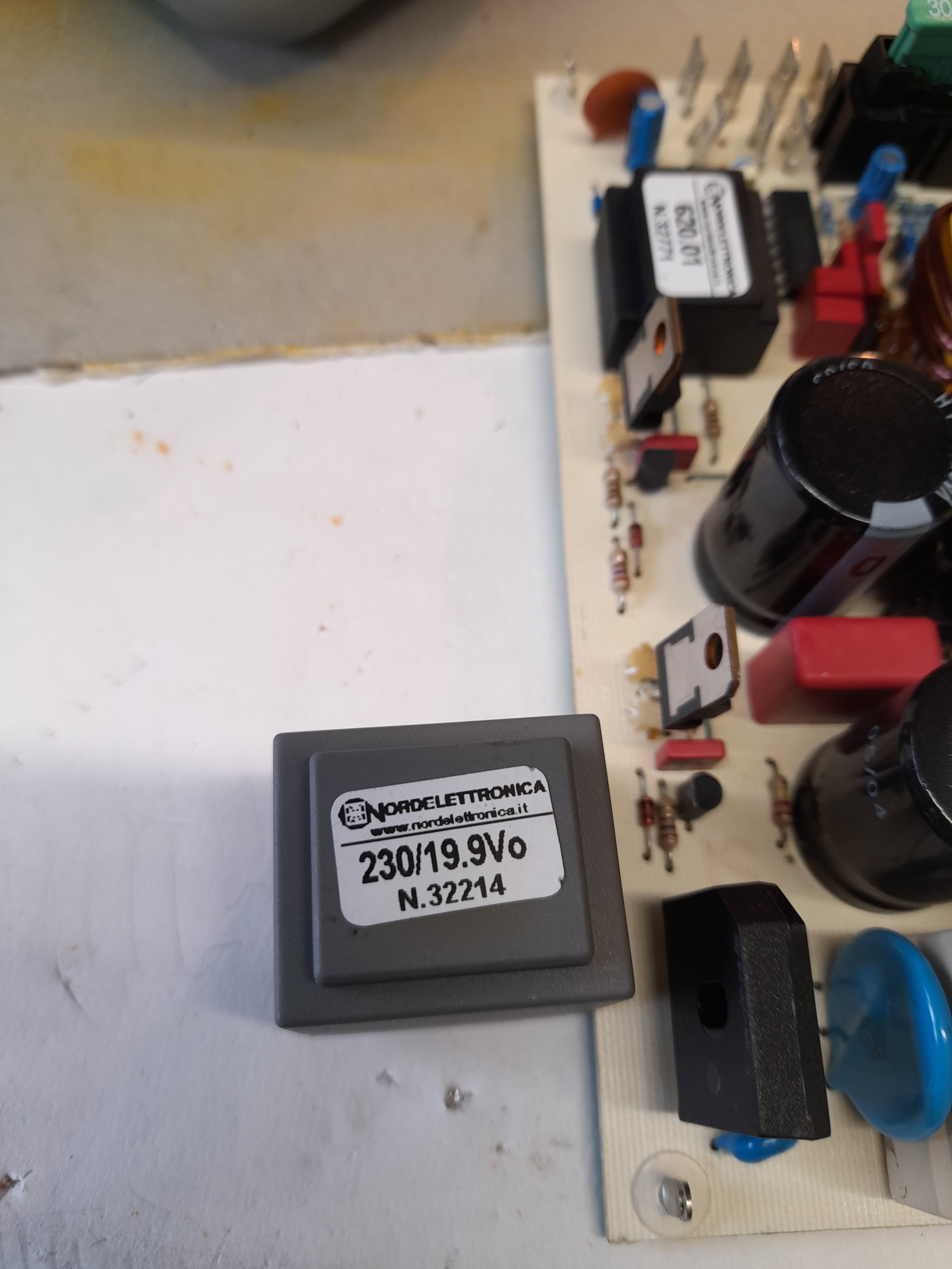

Please see attached photos. This is 12v battery charger, 230v to 14v Leisure Battery Charger.
The charger has failed, and I'm trying to help my customer by repairing it rather than replacing the whole unit.

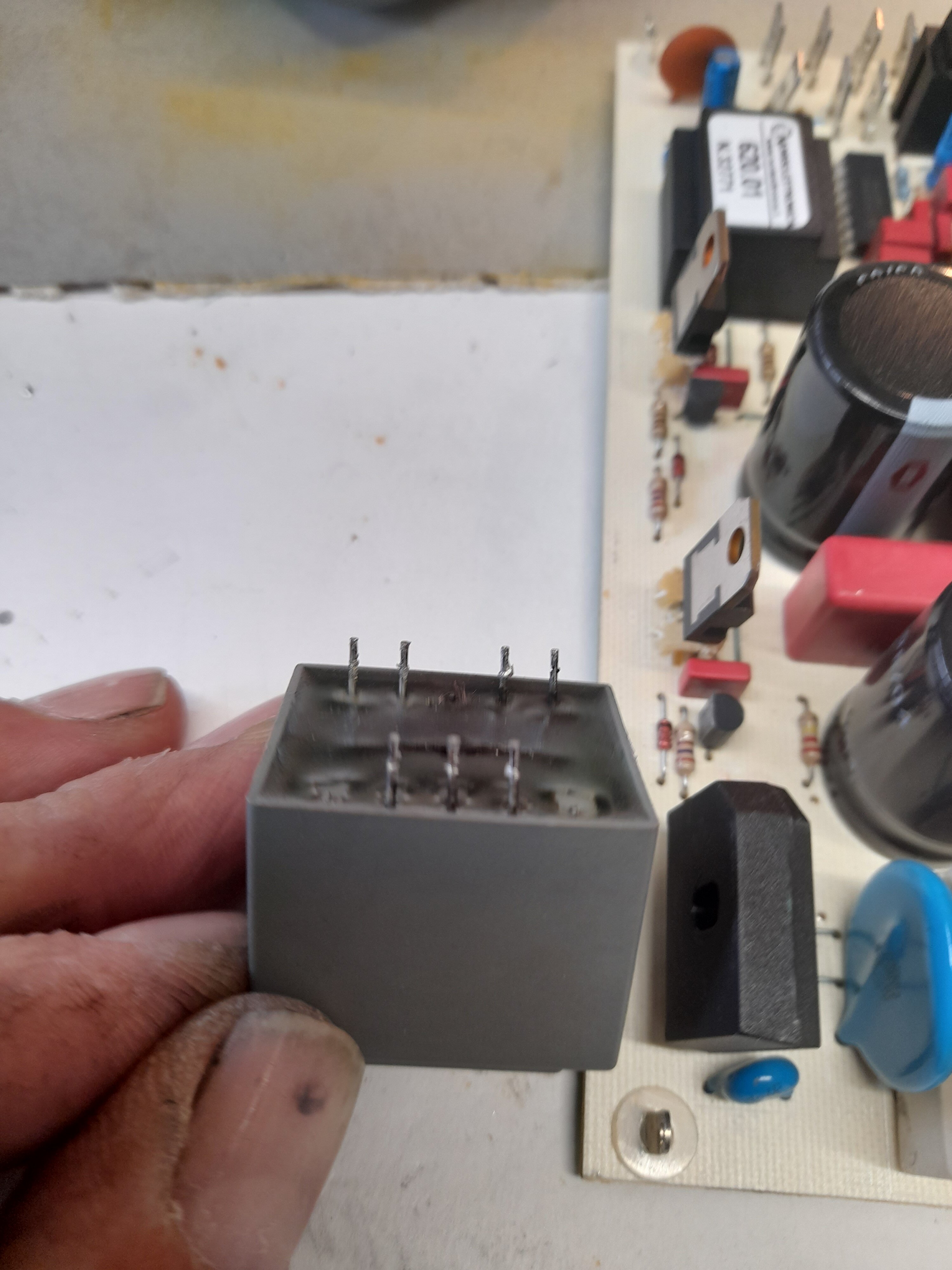

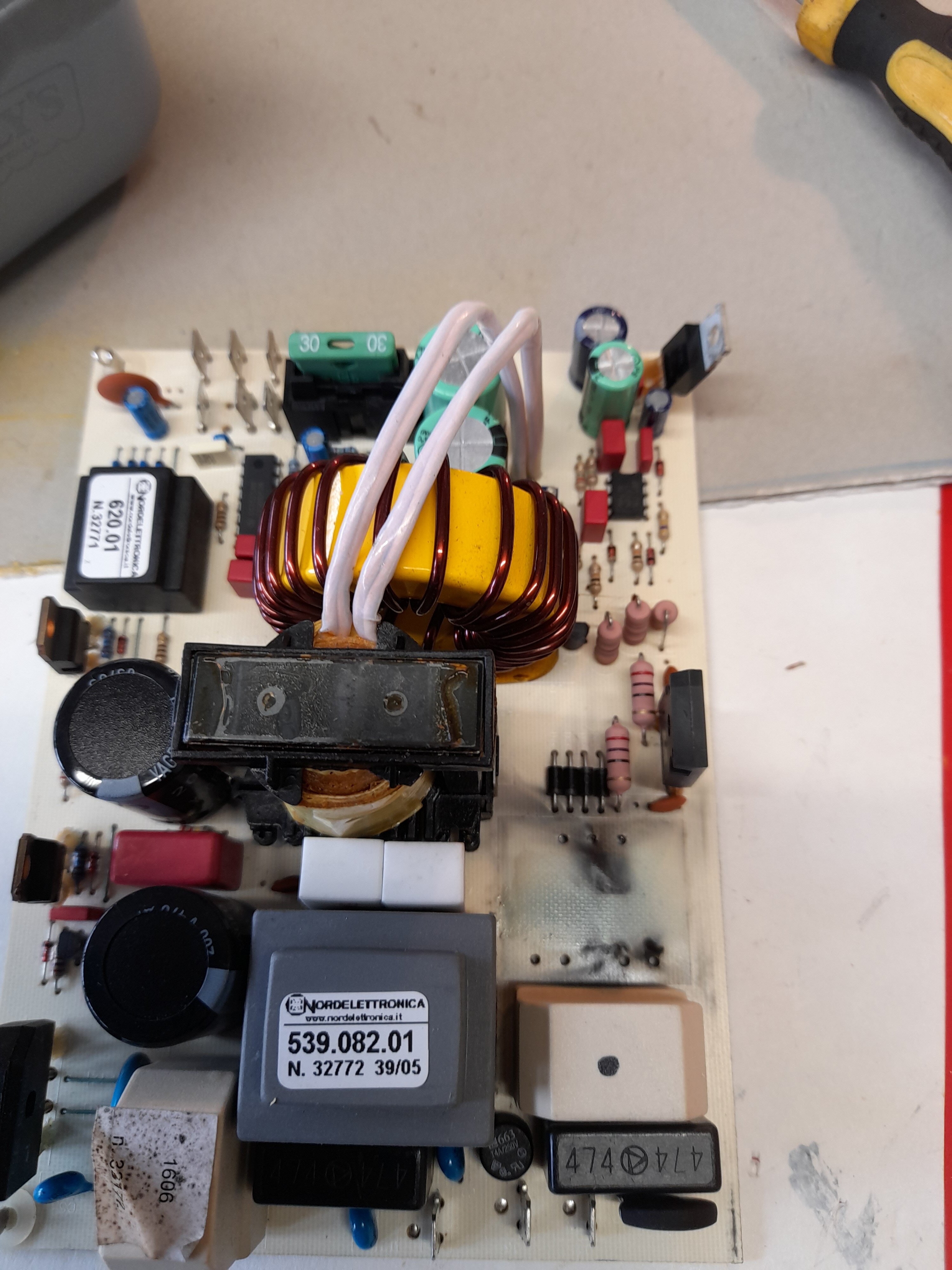

After testing I think this transformer is the cause. As you can see the sooting of the pcb, and the damage on the underside of the block.
I can't find any information about this component. There is no writing on it other than the label you can see. Nordelectronica don't respond even to engineers like myself, they told me that themselves!!
Help would be appreciated.

Custom made switch-mode transformer, almost certainly impossible to source - the only place would be the actual manufacturer of the board, assuming they even keep spares.

I'm not sure that the transformer is a high frequency transformer. I think the open construction transformer between the pictured transformer and the toroidal inductor is the high frequency one. The marking on the transformer that has been removed from the board is marked 230/19.9Vo which MAY indicate the primary and secondary voltages. NOTE the transformer on the board has a different part number. I suggest tracing enough of the schematic to see if the primary is connected directly to mains voltage. This maybe just supplying control voltages.

It should not be difficult to trace enough of the schematic to see if the transformer is supplied at mains frequency or if it is supplied from some sort of high frequency oscillator. (This could be from a switch mode regulator IC or a high voltage transistor or mosfet.)
EDIT. I have just noticed the place on the board where the transformer was removed from. (I thought it was the same transformer removed from another board.) I notice that there a four diodes just above the place where the transformer was located. I think these probably form a bridge rectifier. The part number of these diodes may give us an idea if the transformer is working at mains frequency or some higher frequency.

That looks to me like a low power 50 / 60 Hz transformer. If so, the input resistance will be 1 kOhm or so, and the input will be connected to the mains.
It looks something like one of these:- https://uk.farnell.com/myrra/44268/transformer-10va-15v/dp/1689089
If the original is a main frequency transformer, there may be standard transformers that will work, of you could have an off-board transformer with leads to the circuit board.

If it is in deed a conventional mains transformer, it should be a nice easy fix.
Hi, I do hope so. I've been looking at these last night. I'll order one, if it doesn't work I'll add to my stock .
