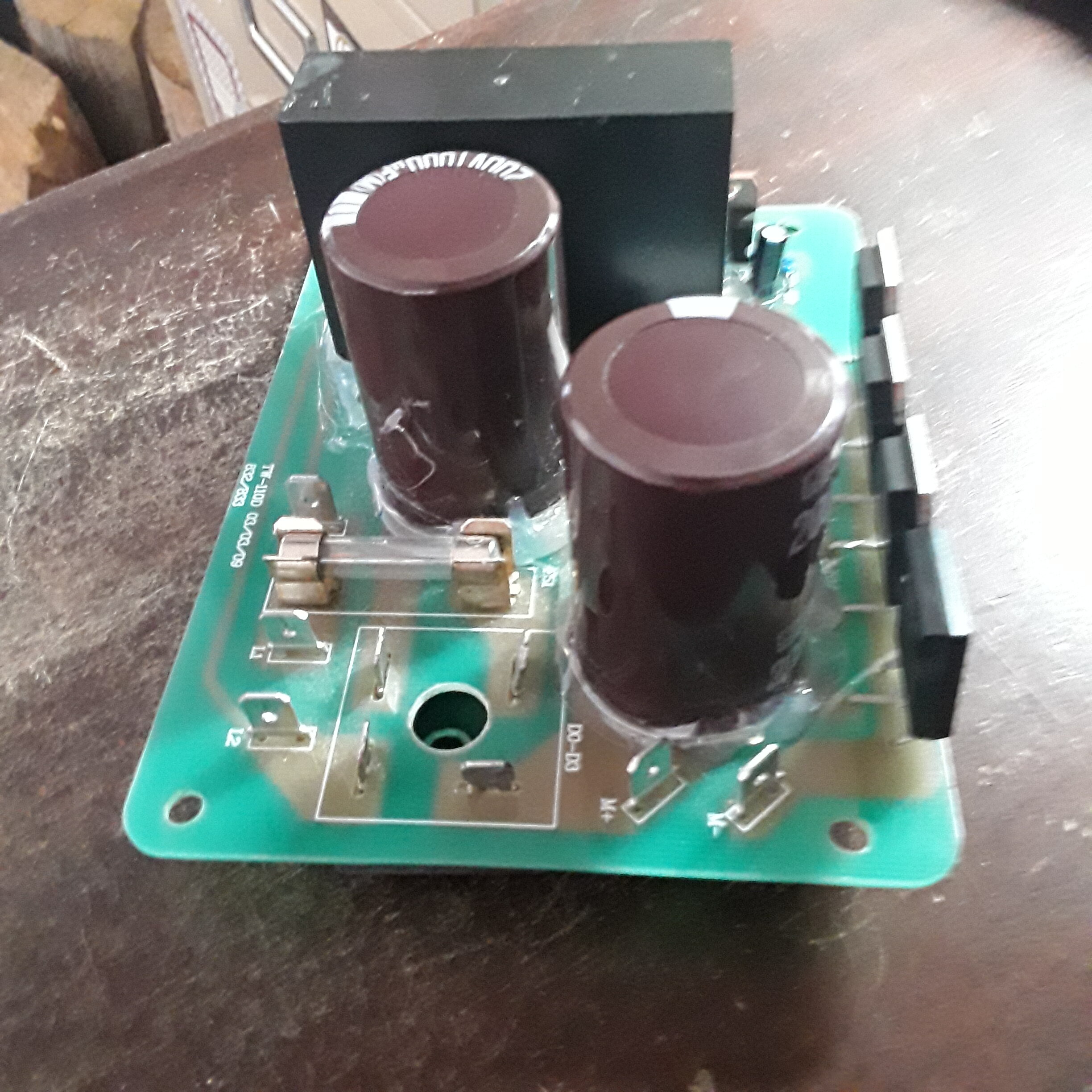

Does anyone know what the black box is on this 110v dc motor pwm controller?

It is an enclosed or encapsulated circuit board, from the diagram you drew out in a previous post.
It has the small-signal or low voltage part of the speed control system.
It will be rather more sophisticated than a 555, with speed and current control and feedback.
It could be a moderately complex analog circuit, or a microcontroller based system.
