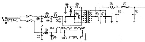

Edit - see the schematic here:
The vibrator is the part just at the left of the transformer; the armature is the horizontal bar & common contact, the coil & drive contact above with its terminal connected to the cap and choke, then the two power contacts connect to the ends of the transformer primary.
The resistor across the transformer is to limit the voltage spikes as the contacts open.
[That diagram has a version with extra contacts for synchronous rectification - you would presumably use high speed diodes].

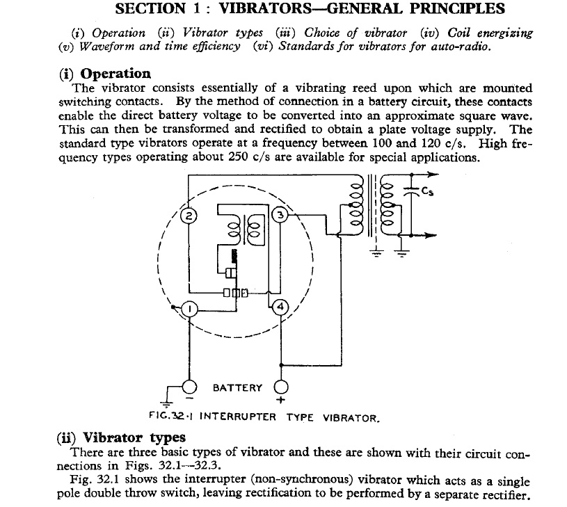

This is supposed to be the base diagram and connections for both the types you mention.
If it will not run continuously, the contacts may be tarnished or burned out.
