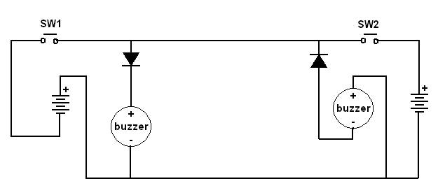

H huang.wencong New Member Mar 2, 2008 #1 Anyone know how to make this? For example if i press the button, the other one will ring. Anyone tell me how to do it?

K kchriste New Member Forum Supporter Mar 2, 2008 #3 You mean like a two way door bell setup? The circuit below will work as long as SW1 and SW2 are not pushed at the same time: Attachments BUZZ.PNG 7.9 KB · Views: 237

blueroomelectronics Well-Known Member Mar 2, 2008 #6 Wouldn't a low voltage AC source on one side work with a little modification?
K kchriste New Member Forum Supporter Mar 2, 2008 #8 blueroomelectronics said: Wouldn't a low voltage AC source on one side work with a little modification? Click to expand... I'd thought of that but wanted to keep it as simple as possible until we get some feedback as to what the OP really wants.

H huang.wencong New Member Mar 3, 2008 #9 KMoffett said: Wired? Wireless? Distance? Ken Click to expand... Wireless. Distance about 50 meters will do.
