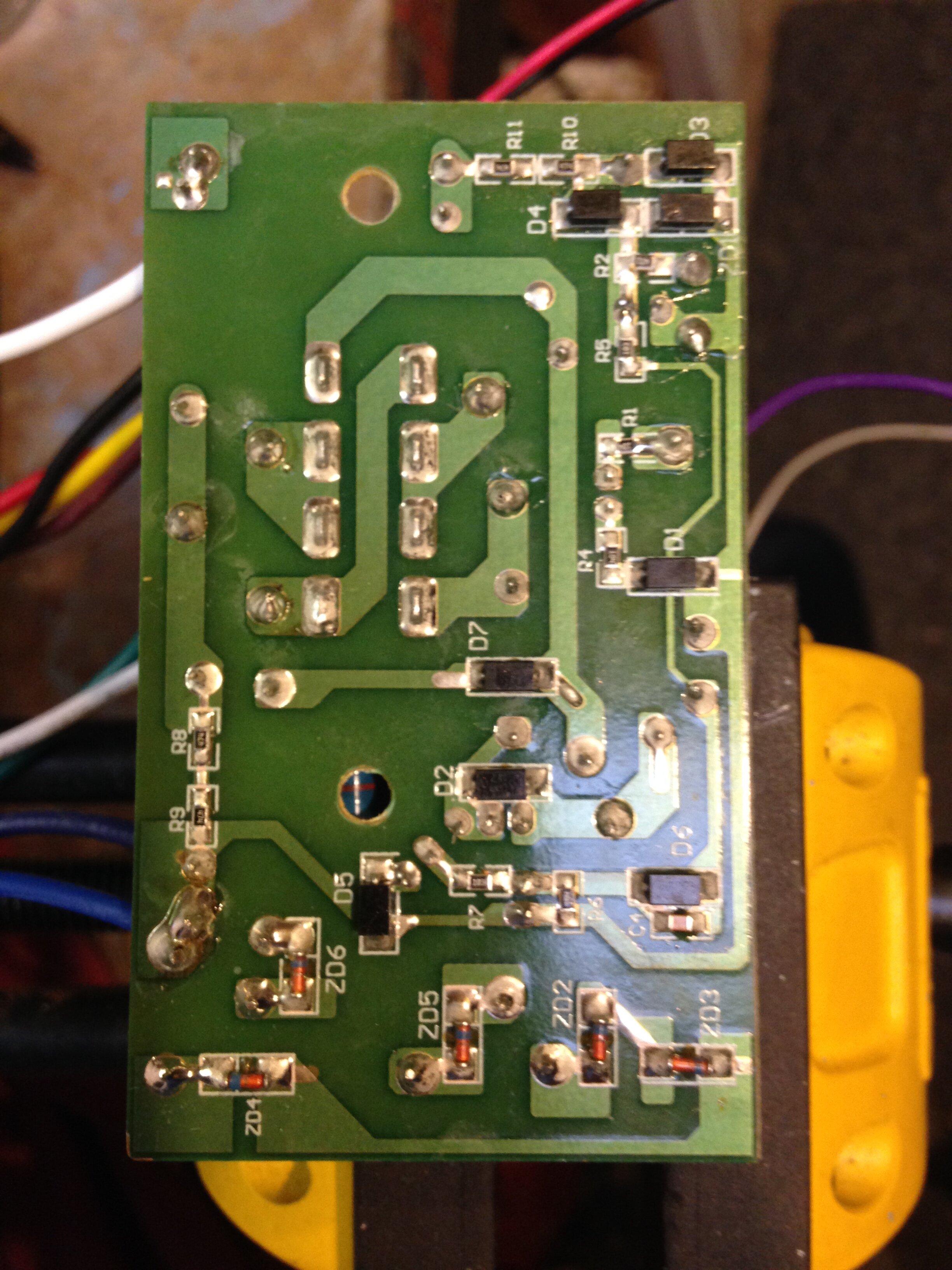

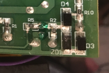

Don't seem to be able to id a diode to put into " Autodesk Eagle" the numbers on it are 15MA-1742A" it looks like a M7 package, like all the other M7's on the board , it is marked has ZD1 on the board, thought it was a Zener Rectifying Diode !.

Likely a Zener Diode. You might have to hook up a current limited power supply and see at what voltage it starts to conduct.
