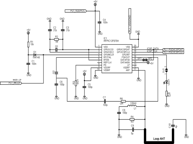

Hi.
Got the latest version of the ICD firmware from the CCS site and in the ICD software(PC) it say that it can handle th PIC16, PIC18 and dsPIC. This is fine, but I wish to use the rfPICs and I get the message " Can't find target......."
So this tells me that the firmware is unable to see the PIC12 series.
What I would like to know is, is there a firmware version that supports the PIC12 series, including the rfPICs, or is there another issue involved??
Built up a little type of dev board for the rfPIC and I think/hope that the connection between the ICD and my board is correct, so do anyone have the ICSP connections sorted out and have got the rfPIC programmed? If you have can you let me know how you did it.

If you just want to program it can you show us your schematic? You'll need to dedicate three pins to the ICD, GP0 DAT, GP1 CLK, GP3 VPP must go directly to your programmer, loading these pins will cause errors.
This is the cct I came up with. It's got the /MCLR pin as well as the CLK and DATA pins as well.

Done, that but still same problems.... starting to think that it has something to do with the ICD... sometime windows does pick up the usb of the icd, and then the icd sometimes pics up a PIC and my target board but doesn't program.

Oh yes on the CCS data they say that there should be a 47k ohn resistor between /MCLR and the 5V line, for the 13V needed to program. Done that as well.
Do you have more than one chip? Sounds like the programmer is not working, bad connection/hookup to the chip or a bad chip.
Have you used the programmer and programming software before with success?
Um.... I found "THE FAULT" it was my eyes/brain..... didn't read the documentation correctly, loom between the "target board" and the ICD was incorrect.
The board is second hand and don't have the ICD cable with the RJ11 connectors, and my demo-board hasn't got the pcb RJ11 connector. So I just didn't have the /MCLR signal connected at all and the rest were going the the wrong pins.
