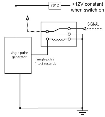

I would like to build a pulse generator that can be used as a single shot when power is on
milkoni

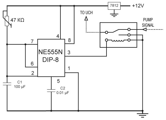

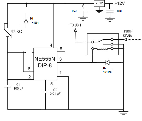

I would like to build a pulse generator that can be used as a single shot between 1 and 5 seconds when power is on and the power is permanent. In first file is principal schematics of my idea. In second is my try with 555 timer. But it doesn't work.
Thanks in advance!

Try googling '555 monostable schematic'.
Your drawings won't work as it shows 12 volts going into a 7812 regulator. The 78xx series have a minimum 2 volt dropout voltage so a 7812 needs a minimum of 14 volts on the input. That is one problem I see.

You pretty much describe a "One-Shot" but what exactly are you wanting the circuit to do, exactly in detail?
Ron
Ron
In detail - When I turn on the power of my car, I would like to cut off the signal from fuel level sensor to ECU for 1 to 5 seconds with a relay (I don't know how long time exactly - I'll experiment with this). After the signal must be restored. The input signal - 12V remains until I turn of the car - it's constant.
When you say 'it won't work', exactly what doesn't happen? Is there 12V at pins 4 and 8 of the 555? Does the relay click and energise?
One thing missing is a back-emf spike suppression diode across the relay coil. Without that the 555 will quickly die.
You really should have something like a 1k resistor for discharging C1 via pin 7. Without that, pin 7 could crowbar the 12V supply if the 47k trimmer were set at a low value inadvertently.
When I said it doesn't work" I meant that it generate more than one pulse when I turn the power on.
That could be due to interference caused by the back-emf voltage spike.

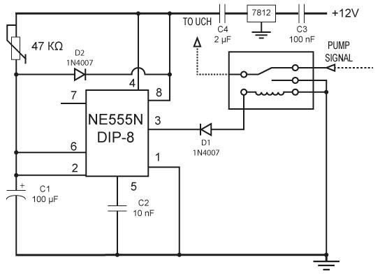

That's because you have pin 7 connected; disconnect it (it is making the system into an oscillator).
For reliability, you may wish to add:
* a diode across the relay coil (anode to pin 1, cathode to pin 3) for back EMF when the relay is switched off.
* a capacitor across the power supply before the 7812 >=100nF and one after the 7812 of >=2uF, for stability of the 7812 regulator.
If you don't want to have to wait for the 100uF to discharge slowly on power off, then connect a diode across the 47k pot. (anode to pins 2/6, cathode to pin 8).
Thanks a lot!
I tested it in Electronics Workbench - perfect. Exactly that I want.
