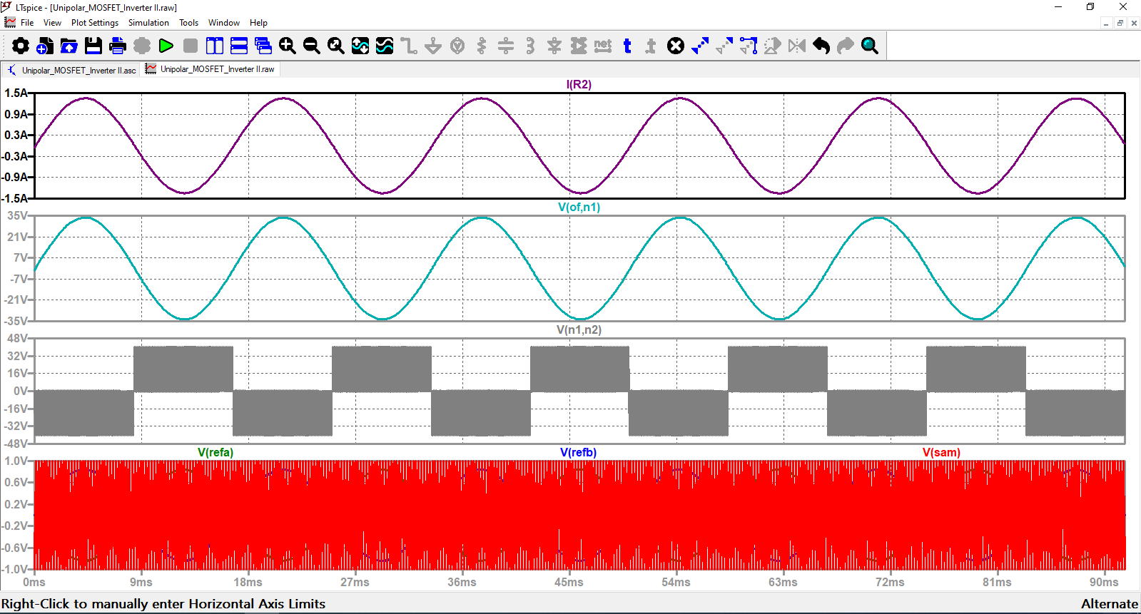

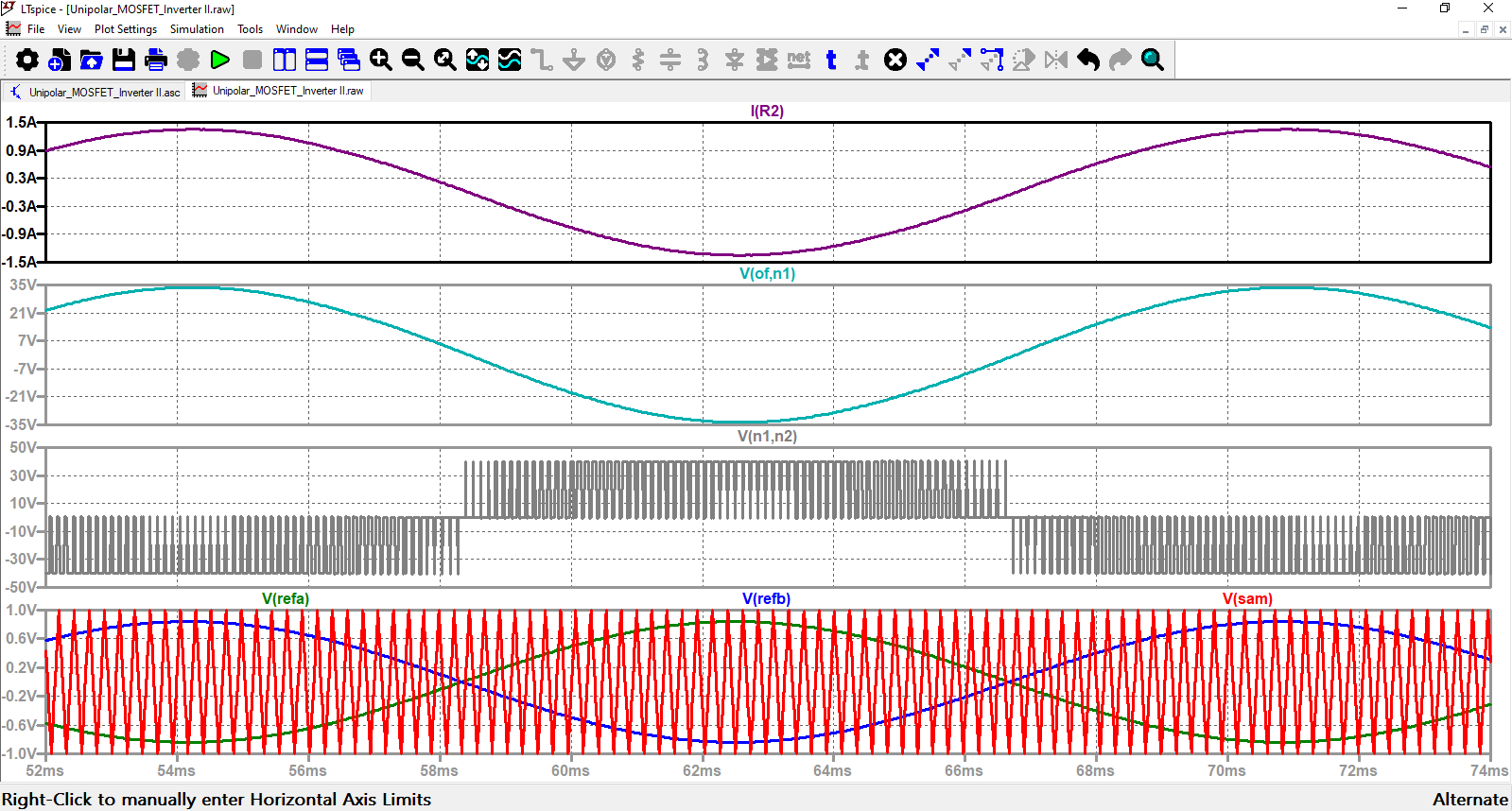

LTspice Simualtor from Analog Devices
The following simulation is not intended for building because it contains high level blocks suitable for simulation that would need to be designed.
@Songrr wrote:
Thank you so much! I've been struggling with this for the past few days, but nothing has progressed, and your reply really points me in the right direction. Thank you very much!
You're welcome
ETA: The original question in this thread was about "Boost Converters". The simulation example is about a DC to AC inverter. The reason for showing this example was that it facilitated my own understanding of the operation of this variation of SMPS (Switched Mode Power Supplies). The book by Hart covers this variation as well as the Boost DC-DC converter.

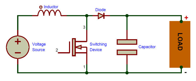

Songrr This is the plan for an unregulated Boost converter. See if you can follow it.
This is summarized from the book by Hart. All DC-DC SMPS are analyzed in essentially the same way.
The purpose of my question is to know the idea of circuit structure
The basic "Boost converter" is extremely simple in principle - in fact the operation is very similar to a "ram pump" for lifting water, dating back to the late 1700s!
The switch is closed for a brief time for current to build up in the inductor. When the switch opens, the current continues to flow as the stored energy (magnetic field) in the inductor discharges.
That current passes through the diode and in to the storage capacitor and load.
Output regulation is by controlling how long the switch is closed (so how much the current builds up) during each switching cycle.
Ram pump -
The "inductance is water inertia in the inlet pipe at 1.
The "switch" is the weighted valve 4, which closes when the water flow is great enough to lift it so it blocks.
The one way valve at 5 is the diode, the accumulator 6 is the output storage & 3 is to the "load" - whatever uses the water.
