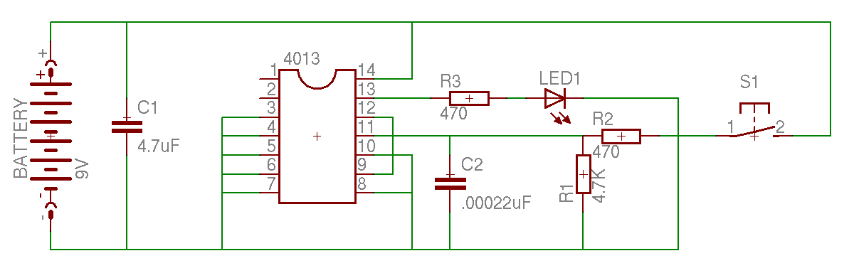

I ran into a problem with my switch
psecody
ok let me start off this thread by stating that this project in no way shape or form has anything to do with school, its just something I've been playing around with.
Well now that I figured out the 4013 ic and got all that working I took an IR reciever module and hooked it up with the output going into a transistor instead of the switch thats in the schematic but the problem is when the power is connected the light lights up then when you press the remote it just blinks it doesn't shut off completely what could be causing this?
Do you think its because the tv remote I'm using pulses and that there needs to be a constant signal for a short time for it to turn on? It seems to me, in theory that it should operate just like the switch was but thats not the case I guess.
Thanks for any thoughts on this.
I think if I get a chance I'm going to build a transmitter that gives out a constant signal instead of pulses and see if that does anything.

The remote for a TV transmits pulses. An IR receiver has an output of these pulses. You need to increase the value of the capacitor a lot, so that the pulses are smoothed into DC. But then the DC won't be high enough to trigger the 4013.
Add a Schmitt trigger circuit (one gate from a CD4093) to boost the voltage of the smoothed DC, speed up its edges and invert it.
so I need a bigger capacitor to smooth out the pulses but why would the voltage not be high enough to trigger the 4013? I mean once the transistor is open then it comes 9volts directly from the source.
The output of the IR receiver goes high to +5V and goes low to 0V. The smoothed average voltage when it is pulsing is only 2.5V. The minimum voltage for a logic high for the CD4013 is +6.3V when it has a 9V supply so it must be amplified.
Even a CD4093 has a minimum logic high voltage that is about 5.3V so it also won't work. You need a transistor to convert the voltage then a Schmitt trigger to speed up its edges.

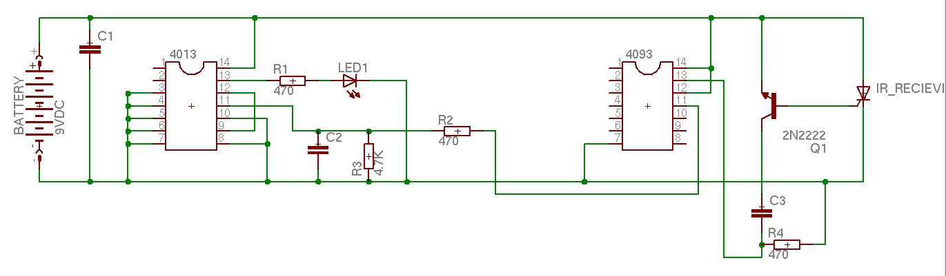

ok I redrew the circuit and added some stuff. Is this what you were talking about with the other IC? I'm not sure I got it right but its what I gathered from your description. Thanks for the help

hi pesecody,
The first problem is that the TV remote is transmitting a stream of pulses,
which if you keep your finger on the remotes button will be a continuous stream.
If your detector is feeding these pulses via the 4093 into the 4013 clock input
then the outputs of the 4013 will be switching at the same rate as the TV pulse stream and you will not be able to see it switching with your eye.
If you increase the value of the capacitor from the 4013 clk input to ground,
to average out these pulses to a dc voltage, then you are going to have the same problem as your first circuit.
That is when you take your finger off the TV remote button the voltage at the 4013 clk input will decay slowly and cause the 4013 to switch erratically.
Remember the 4013 expects clean/fast edges on the clock pulse.

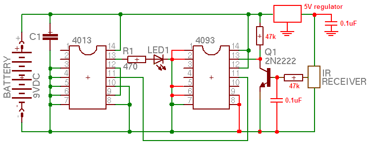

Assuming you are trying to make a remote control switch?, you're going about it in completely the wrong way!.
You need a micro-controller, either programmed yourself, or the Holtek pre-programmed remote control endocer/decoder chips.
The IR receiver needs a 5V supply but the CD4013 needs 9V for the LED to be bright enough. Therefore the IR receiver needs a 5V regulator and the transistor converts the smoothed 5V pulses to a +9V ramp. The CD4093 Schmitt trigger makes the edges fast enough to clock the CD4013 flip-flop.
You had your transistor upside down.
Your entire schematic is backwards since usually the input is on the left side.
This circuit might work. Increase the value of the smoothing capacitor if it mutiple triggers.
